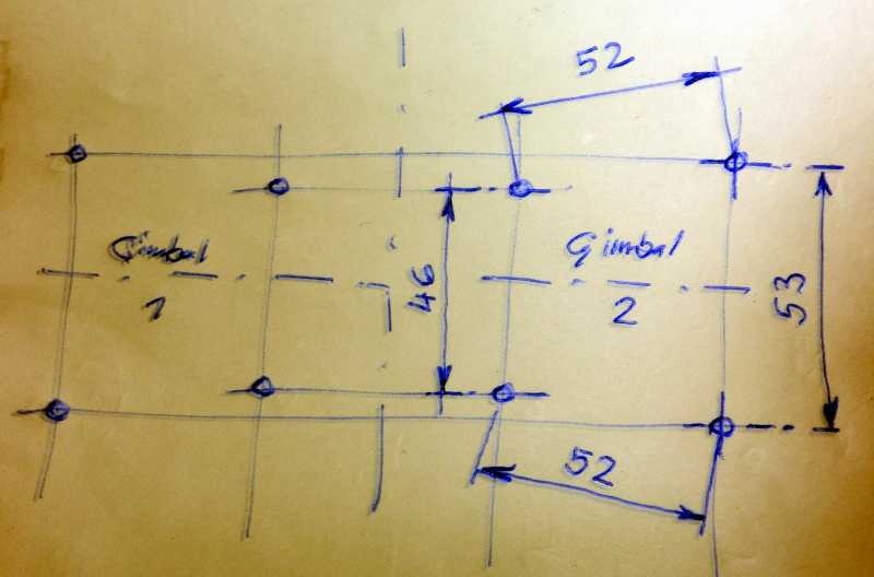

hello to all
I have a question regarding the screw mounting hole spacing for the 2 outer screws of a Devo 8S gimbal, the screws are internal unlike many other radios. If anyone with a set of verniers could please measure this I would be most grateful for the answer.
The inner mount holes are not so critical as I can see from pictures that they are differently spaced (slightly offset) to the outer ones.
Reason for needing this info is so that I know if I can fit one of my 3-axis gimbals instead, spacing for that is the normal 52mm. I don't want to buy an 8S and find that it's unsuited for my purpose.
Thank you kindly to anyone who can help with this.

hello Gerhard
yes, that's correct, all three motion axes on one stick.
The 3 axis gimbals I have are 52mm spacing on all four mounts, which fits many radios. The mounts in the 8S I can see in pictures are not uniform spacing, but as long as the 2 holes nearest the edge of the case are that same measurement then I can make new mount points for the other 2.
I know the Devo 10 is the correct sizing as it's the same case as earlier WK series, but Devo 8S I'm not sure about.
If you should get an opportunity to measure it for me that would be great, thank you.

That is absolutely excellent Gerhard, I am most grateful for the effort you have put into providing such a detailed response.
53mm is fine, the mount holes are large enough to compensate. I can see from your sketch that this gimbal will work out fine, so now I can see about ordering the radio.
