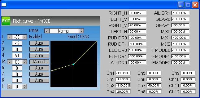

While playing around I noticed that the values displayed are not the expected. I have loaded a new model, changed to standard and loaded the 6Ch-template.
I tried to play with the issues jvulte mentioned and suddenly came to this:
This is obviously wrong. When you change the "H" value the graph changes as expected, but when you change the "M" value it also changes the H-point...
When I first looked at the curves everything was fine. I don't know when it changed.
I will file a ticket on bitbucket for this.

I am unable to reproduce this behavior on the emulator after following what you've got above. It probably means some variables are getting corrupted, so if you can document step-by-step from a clean model exactly what you pressed so I can see it, it would definitely help

I get the same result as above (Devo8).
1) loaded a new model,
2) changed to Standard GUI,
3) loaded the 6Ch-template.
I'm not shure it is correct to load Heli 6Ch-template with Standard GUI.
at template: curvetype=5point
at Standard GUI: 9point

Replied by rbe2012 on topic Couple questions for 3.0
It is very easy. I cloned your actual repo (parent: 1582:1ae61a3d88c3 tip (Fix default icon assignments. Fixes #319) in a new directory so all files were created new, ran "make TARGET=emu_devo8 WINDOWS=1" and started the emu.
Then I took a new model, switched to standard mixer gui, loaded the 6-ch-template (
) and looked at the throttle curve.
I have made a screen video where you can see this:
When you look at the video you will throw your hands up in horror... I have realized yet what I have done and I know now that it was wrong.
My fault, maybe, but this is a way which is not suppressed from the gui - so I will not stay the last who tries it. Choosing a template when the standard gui is selected should only allow the "Heli/Standard GUI" template (or the mode should be reset to advanced).
EDIT: This will be my destiny: every time someone is faster than me...
