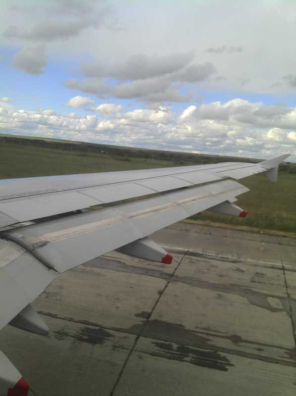

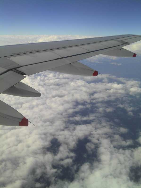

Bonus pics from earlier today: Airbus 318 wing with and without flaps. Missed the shot with the airbrakes.
Devo 10 + 4in1
FrSky Taranis + TBS Crossfire

Iám also on the road last 2 days,
thanks for the flight pictures..
Grettz from Germany
