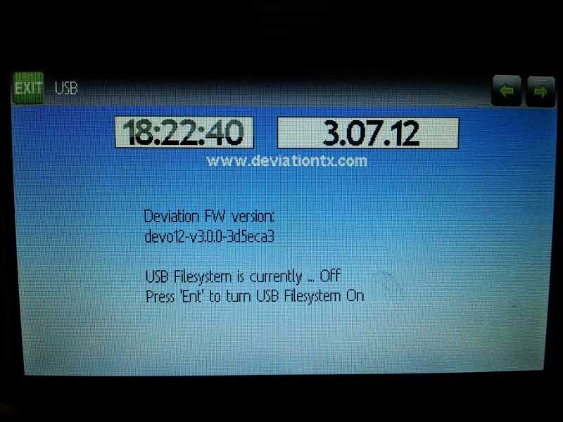

Came across my first Devo 12s reboot today. I compiled the deviation sources this morning so I am using the latest code (3d5eca3). This is reproducible every time I try. My errors.txt contains only "Empty".

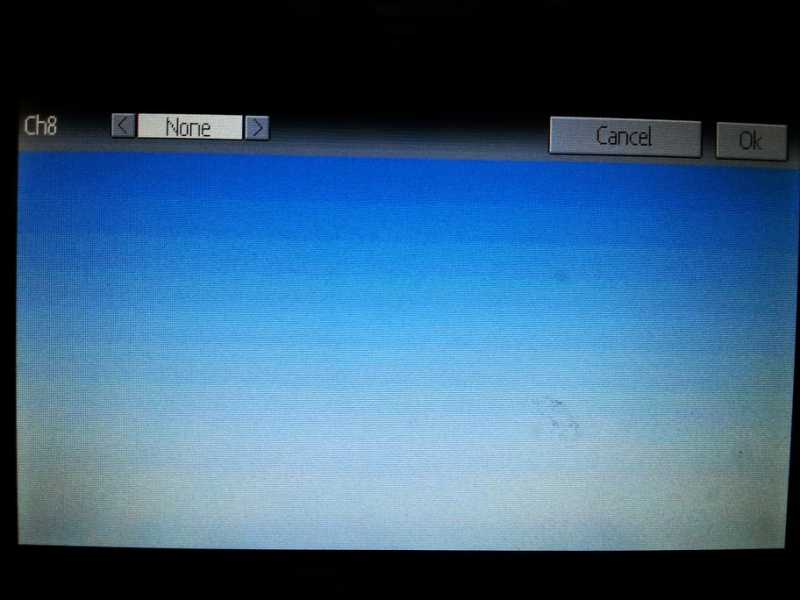

I wanted to set Ch8 to use the Rudder DR switch to output 3 values (For Eagletree OSD menus). Click "None" beside Ch8

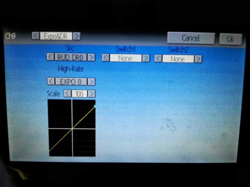

Then set src to RUD DR0:

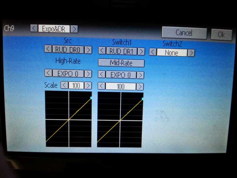

Then set Switch 1 to RUD DR1:

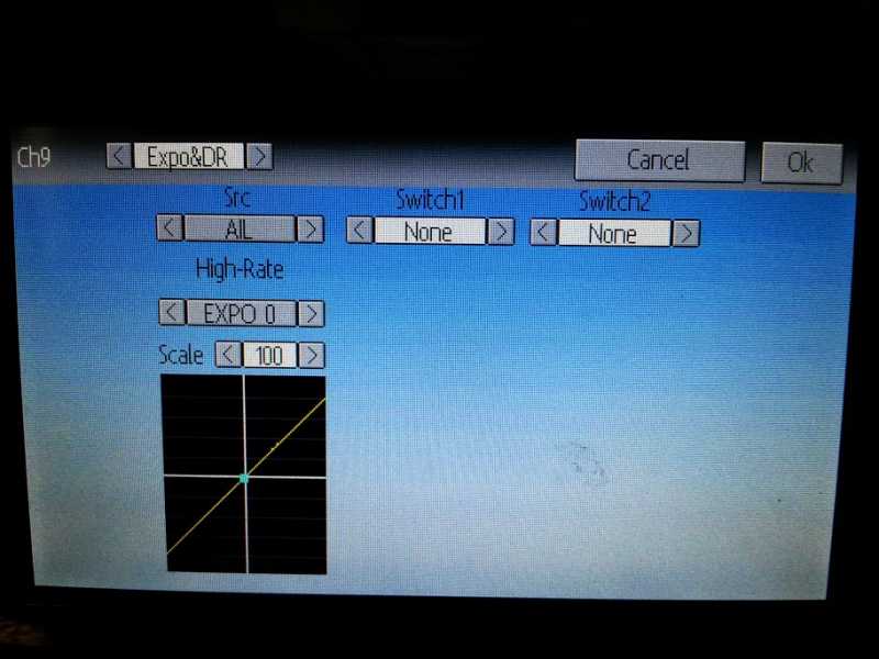

Now at this point, when you go to choose RUD DR2 for Switch2 .. the first entry in the selectbox is AIL, and the TX reboots.

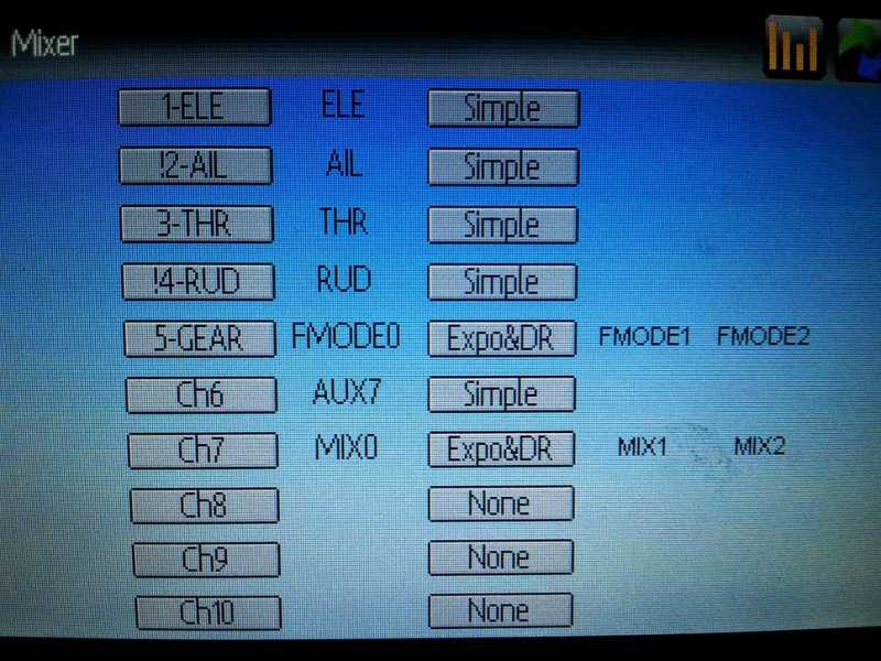

Current model I am editing:
When editing an existing model:

Nice catch on this bug, and thanks for documenting it so thoroughly.
It was a memory corruption bug caused by trying to update the trim widget (which only exists on the complex page). The bug has been there for quite some time I believe.

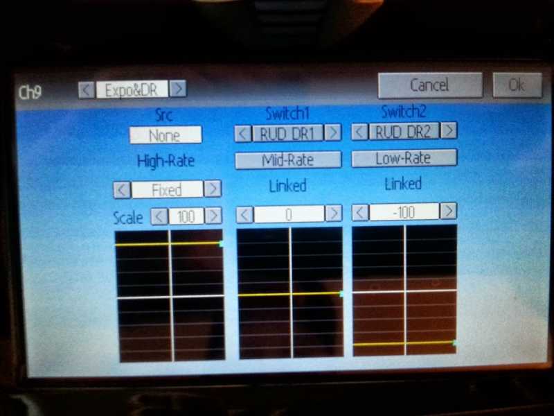

04 Jul 2013 03:23 #11839
by adabman
This is what I was trying to accomplish for CH9:
Its all good now.
Deviation
1 TX to rule them all...
Replied by adabman on topic Devo 12s reboot bug
Kdean wrote: Could it be that you cant use the switch as the source? Should the source not be a channel or aux?
Its all good now.
