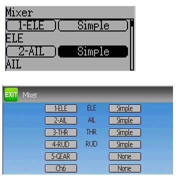

I just built the devo7e emulator to have a look... no offence to anyone's work or choice of purchase, but that gui is... well, interesting...
The menus are actually the same, it's just that they are "zoomed way in".
The devo12 touch screen is a thing of beauty... ;) That's all I'll say.

06 Jul 2013 10:59 #12010 by FDR
That is because the DEVO 10 interface inherited a simplified version of the DEVO 8 interface.
The size is determined by the font size, which is quite big to support the chinese letters, and while the 7E is not internationalizable, it has the same interface as the 10...
08 Jul 2013 16:47 #12097 by Scream
Hiya!
Could the font size be automatically resized based on language selected?
I'm thinking this way, English could use a smaller font, French might need a slightly intermediate font (with its chapeaus and accents), ect...
Thanks!
-=S=-
Cheers!
-=S=-
08 Jul 2013 18:00 #12102 by FDR
In theory yes, but then you would need different layout too, which is hard coded ATM...
09 Jul 2013 03:54 - 09 Jul 2013 03:54 #12115 by PhracturedBlue
Replied by PhracturedBlue on topic Welcomed feeback, I hope so. An outsider lookin in
For pages using the 'Scrollable' widget (basically anything with a scroll-bar), it would not be too difficult to support a smaller font and rescale. There are other pages where that would be completely infeasible though. It would be an interesting experiment to try, scaling the display based on the selected font.
Last edit: 09 Jul 2013 03:54 by PhracturedBlue.
09 Jul 2013 04:47 #12116 by sbstnp
Smaller fonts require more objects thus more memory. If we were to automatically scale the display then we probably should:
1. allocate memory dynamically (probably not the best idea)
2. allocate max number of objects regardless of how many would fit.
As PB said, some parts of the UI are very painless to transform (like the menu, mixer, or settings pages), others not so much. There are lots of assumptions and hardcoded things and getting rid of them will take a while.
Devo 10 + 4in1
Spektrum Dx9
FrSky Taranis + TBS Crossfire
09 Jul 2013 04:59 #12117 by PhracturedBlue
yep, we'd up the max objects from 4 to 7 or 8 (I think my smallest font is the 04b03 font which is 5+1 high. So leaving a single space above, you could fit 9 rows which is 8 + header.
That font isn't the prettiest in the world, but it is pretty small. the next size is the 5x7 fonts which can fit 8 rows (7 + header). Both are ascii only, and I'm not sure you could even support the Latin character set with it much less Cyrillic.
While there are a lot of hardcodes, Each page is put together in basically the same way, so it would be a relatively easy, though tedious, chore to fix each page.
I probably won't attempt it right away, myself though.
