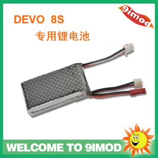

30 Jul 2013 15:12 - 30 Jul 2013 15:15 #12617 by richardclli
Replied by richardclli on topic Devo 8 battery
Not sure why you all have so many discussion on this thread. I am using 2S LiPo battery to power up the Devo8S without any problem. Walkera officially has a 2S battery pack for Devo 8S for sale. I feel quote strange when I read this thread.
Last edit: 30 Jul 2013 15:15 by richardclli.
30 Jul 2013 15:23 #12618 by FDR
Replied by FDR on topic Devo 8 battery
I've never seen that Walkera even mentioned using LiPo in the DEVO 8.
The specification says:
4). Battery: 1.2VX4 NiCard or1.5VX4 AA dry batteries
Only some vendors (like 9imod you linked) do offer such options...
