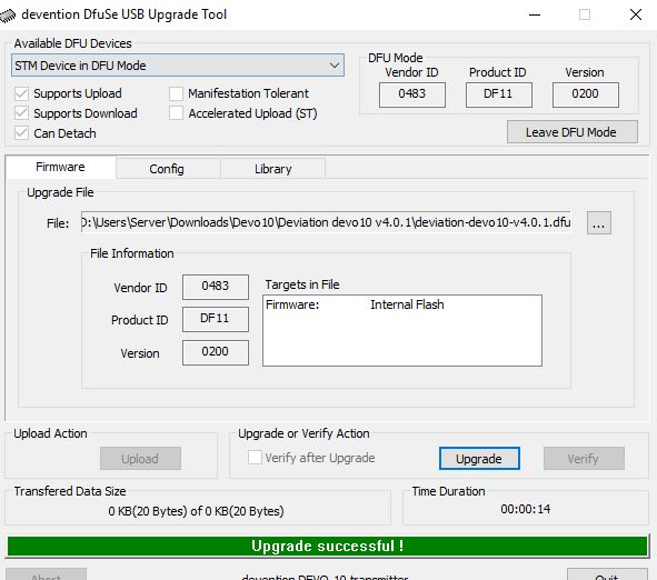

Ok, I am using now Dfuse USB Upgrade Tools 2.31 now, after installed USB driver for WIN10: DFU USBDrv Installer-1.1
the dfu files are:
DEVO-10 Fw v0.8B.dfu
deviation-devo10-v4.0.1.dfu

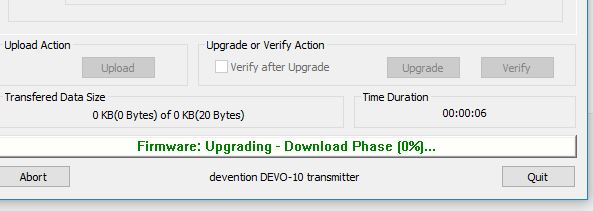

ugrade tool looks good so far, but if IU start an upgrade it stucks in
"Firmware: Upgrading - Download Phase (0%)" for a while and then switches to "Upgrade successful!"
04 Sep 2017 20:28 #64169
Replied by Deal57 on topic Devo10 stuck in update mode
It looks like the upgrade is working. You need to use the Deviation 5.0.0 DFU... there are three choices:
1. Release version is called "deviation-devo10-v5.0.0.zip" - the last stable release
2. Release version with additional protocols is in this thread.
3. Nightly Builds are for developers or testers, or just plain edgy-kinda users.
You do not need the file DEVO-10 Fw v0.8B.dfu; I believe that is walkera stock firmware.

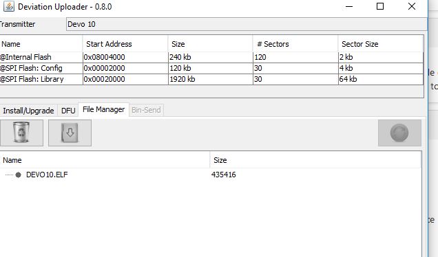

with the deviation update tool I see with file manager that the file DEVO.ELF is on the tx

I tried now both, the DFUse tool 2.31 and the deviation uoload tool 0.8.0, all seems working but my devo 10 still stucks in Programm Upload.... immediateley after power on.
I used both, the original DEVO 10 firmware 0.8b and the deviation firmware deviation-devo10-v5.0.0.dfu w/o success
any ideas?
any ideas?

12 Sep 2017 14:44 - 12 Sep 2017 15:08 #64367
Replied by vlad_vy on topic Devo10 stuck in update mode
Probably EXT button problem? Do you hear any click when you press EXT button?
Also, try to check "Verify after Upgrade" and flash (Upgrade) firmware. If will be any error probably you have problem with flash memory chip.

15 Oct 2017 21:31 #65085
by pesa1
Replied by pesa1 on topic Devo10 stuck in update mode
Hi vlad_vy,
thanks for your reply. I followed your instruction and indeed now the Dfuse tool shows me the correct information. After the upgrade and power off/on the Devo10 has now a white display.
What is the next step?
by the way I used now v5.0.0 firmware
