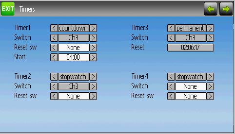

The first and third timers are what you expect; the second if more a proof of concept than of any practical use: I try to keep an eye to the flight time (like counting used batteries) to give my heli a break to cool down after some time.
I just wanted to point out that I use timer 1-3 without any issues since a longer time on Devo12 and Devo8.
My config usually looks like this:

Here is config with model it had timer 2 issue with.
I just set timer 3 with exact same setting as I initially set up timer 2 with and it worked as expected. Don't know why timer 2 wouldn't cooperate.

Well, your timer2 has no switch configured. However it has a reset switch !RUD DR0. BTW it is a permanent timer too...

Only one permanent timer will work correctly. I would have to look into the code but I am quite sure that only the value from the last will be saved.
But they all should be running (on main screen if they are visible) when the switch is set to ch3.
The reset switch configured for timer2 will set the timer to 0 even if the switch condition (ch3) is true. So if your RUD DR switch is not at position 0 you will not see it running.

Yes, I have no switch configured for timer 2 because it wouldn't work so I made timer 3 have the function and left 2 out of the picture.
I wanted timer 2 to be permanent timer, but wouldn't work so I made 3 the permanent timer instead with what I thought were the exact same settings and it worked.
I am thinking perhaps if I had a reset switch for 2 and didnt realize it that may have been the issue as rbe2012 states below.
