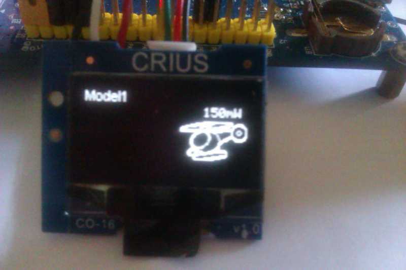

11 Oct 2013 14:15 - 11 Oct 2013 14:17 #14498 by SadSack
Replied by SadSack on topic Devo f7 for DelFly
I had a thought and bear in mind I am no coder but! There's a timer for back light on devo7e/10 couldn't something like that be used but tx display just disappears or just middle area ? Still all off would be better.
Microuav would you be able to do a dissembled photo shoot of F7? pretty please :) Have looked but didn't see anything.
Well that screen is very nice. Its same one used by LadyAda There's lots of info there about it. Its I2c, 3/4 wire serial. The Cruis OLED is flawed and to make it work you need to disconnect reset from 3.3v! And add cap/res and works great I2C only 3.3v/5v
Now all I did was change few codes in PB's lcd.c. All will be good once i figure out how to read datasheet :-). I broke my proper replacement screen for Devo7e not sure how or why guessing i got internal regulator codes wrong. Only had 1 screen so had to stop. Then I saw that and thought what the hey. Well I did get it going first time but text/graphics back to front(found right code in the end) But Idea popped in to my head FPV and use that screen as HUD. If you can cut your own PCB's www.buy-display.com/default/oled-display...-display-module.html $3+ shipping I got my Devo7e screen there as well
In all its glory
Last edit: 11 Oct 2013 14:17 by SadSack.

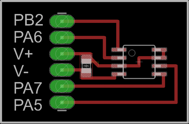

25 Oct 2013 13:53 #14959 by SadSack
The pdf you linked is all but same as microchips. I know 2meg in devo7e 4 meg in others.
Not much good to you but here's my working circuit from devo7e. Not great and maybe not much good to you.
25 Oct 2013 19:53 #14977 by Microuav
Replied by Microuav on topic Devo f7 for DelFly
Tnx, but already knew what ports it was at. It's at the same SPI bus as the video overlay chip.
I think like 99% of the connections to the STM32 are the same as on the devo7e, I checked a couple of them and they were all correct.
