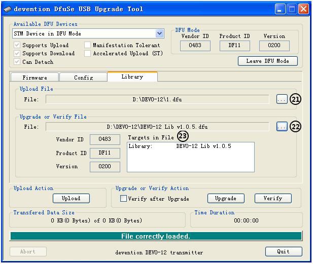

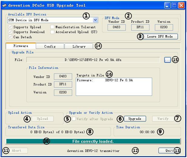

When Im in the Dfuse tool it wont let me click to upgrade
14 Oct 2013 05:57 #14595
Replied by vlad_vy on topic Newbee wanting to go back to devention
1. Press 'EXT' button and power on Devo 6
2. Run Dfuse
3. At 'Firmware' tab select at 'Upgrade File' = firmware file
4. Press 'Upgrade'
5. At 'Library' tab select at 'Upgrade or Verify File' = library file
6. Press 'Upgrade'
2. Run Dfuse
4. Press 'Upgrade'
6. Press 'Upgrade'

Hi vlad_vy, I'm following the instructions and I see were youre telling me to click on Upgrade however it is not allowing me to select it as an option.
16 Oct 2013 04:09 #14681
Replied by FDR on topic Newbee wanting to go back to devention
Does your DfuSe recognize the tx?
It should be displayed in the top left dropdown...
