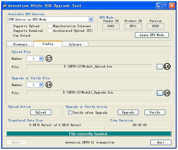

www.walkera.com/en/updater.php
Open Dfuse at 'Config' tab, select model number at 'Upgrade or Verify File' (19), select model file at (20), then press 'Upgrade' button.

sir vlad_vy i can't figure out where to get D:\DEVO-12\Model1_Upload.bin and D:\DEVO-12\Model1_Upgrade.bin? i already upgrade my firmware of devo 7e but this is my problem, thanks
09 Nov 2013 06:14 #15454
Replied by vlad_vy on topic set up for devo 7e for biggeners
In your case (Devo7e) it will be
Upgrade or Verify File: 'Mini cp-7E.bin' then press 'Upgrade' button.
