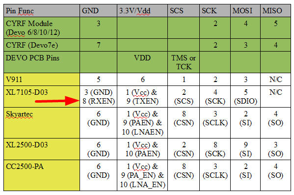

The A7105 (which is the module I used, from a V911 Tx) only has 6 pins, so it's not shorted. The 9-pin version of the 7105 is the XL7105. I had to open the thing up and look to figure out that this was the case.
Since the A7105 doesn't seem to have a RXEN pin listed, could it be pin 4 (which isn't listed as connected)?
Something about the A7105 (aka V911) Tx module I should check on?
thanks,
Mike

vlad_vy wrote: Check if yout A7105 module has pin 8 (RXEN) grounded (8 to 3).
thanks,
Mike

I installed 3.10 beta 8 on it. No more bind lockups. So either 1) this was an issue that was fixed in 3.10, or 2) I tweaked something mechanical while poking at the A7105 to not check pin 8.
