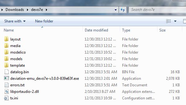

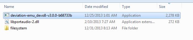

I did as you said, but I still can't run the emulator. I would see a command screen and then it would disappear and stop running.
I have attached the a screen shot of the folder where I saved the file system and and the EMU package. Can you please let me know if I'm missing something? (This is from the nightly build a few days ago.)
Thanks again for your help.

31 Dec 2013 04:40 - 31 Dec 2013 04:40 #17545
Replied by PhracturedBlue on topic Installing the EMU to create models on my PC
the devo emulator should have a dir structure like:you have everything flat in the top level directory which is the issue.
emu_devo8.xxxx.exe
*.dll
filesystem/devo8/
media
models
language
Last edit: 31 Dec 2013 04:40 by PhracturedBlue.

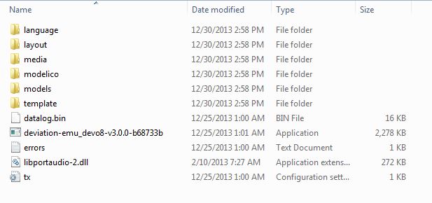

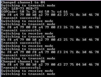

I changed the file structure like you mentioned (the FS is Devo8), and the emulator came up, but then disappeared again after about 5 seconds.
I have attached a picture of the File structure you mentioned and a screen shot of the last line of code in the command screen, before the emulator shuts down and disappears.
Please let me know if you have any other suggestions I can try.
31 Dec 2013 16:44 #17580
If you saw my previous post, ignore it.
Try this:
dl.dropboxusercontent.com/u/52854517/dev...8-v3.0.0-0c78016.zip
I just built and tested that it works. No need for a filesystem as it is included.
Try this:

31 Dec 2013 19:23 #17595
by coryroyce
Replied by coryroyce on topic Installing the EMU to create models on my PC
I tried running based on what you sent, and the command screen cam up and was running code, and then just stopped. No emulator ever came up.
I'm running Windows 7 on my PC, could there be any restrictive settings that do not allow it to run?
Thanks again for your help!
