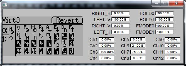

You may take a look at the screen shot.
When I choose a channel as the input of toggle (Virt3 for my case), press "DN" cannot go down to let me choose icon for "1", while press "UP" will make the underline of "0" also disappear too
As a workaround, I need to first choose any switch (e.g. FMODE) as input, choose icons for "0" and "1", then change to my desired channel later

Thanks for explaining. That is a bug on the Devo7e/10 only. I have fixed it and it will be in tomorrow's nightly as well as the 4.0.1 patch I'll be making.
