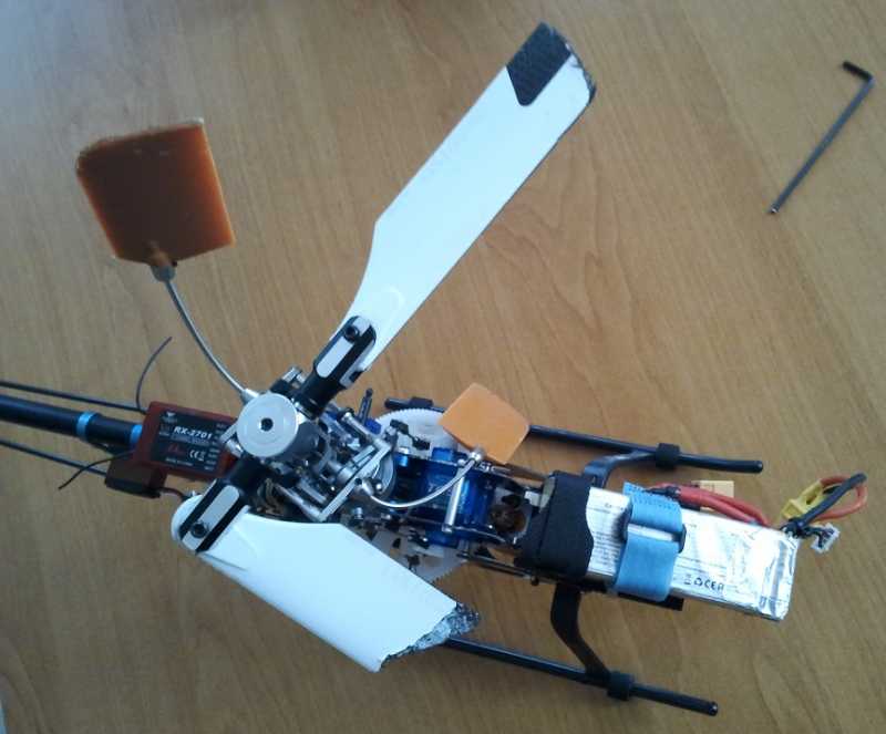

Well, if not total loss, but close. Trex 450 Sport clone with Align parts.

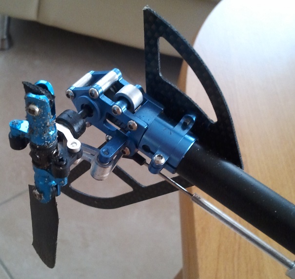

Lost the blades, all 3 cyclic servos (luckily the Align DS425M on the tail survived) the flybar, paddles, helical main gear, main axle, feathering shaft, tail blades broken, tail spinner bent, tail blade holder and basically all bearings are full of sand... have not checked all head parts (full metal) yet...

Pictures
