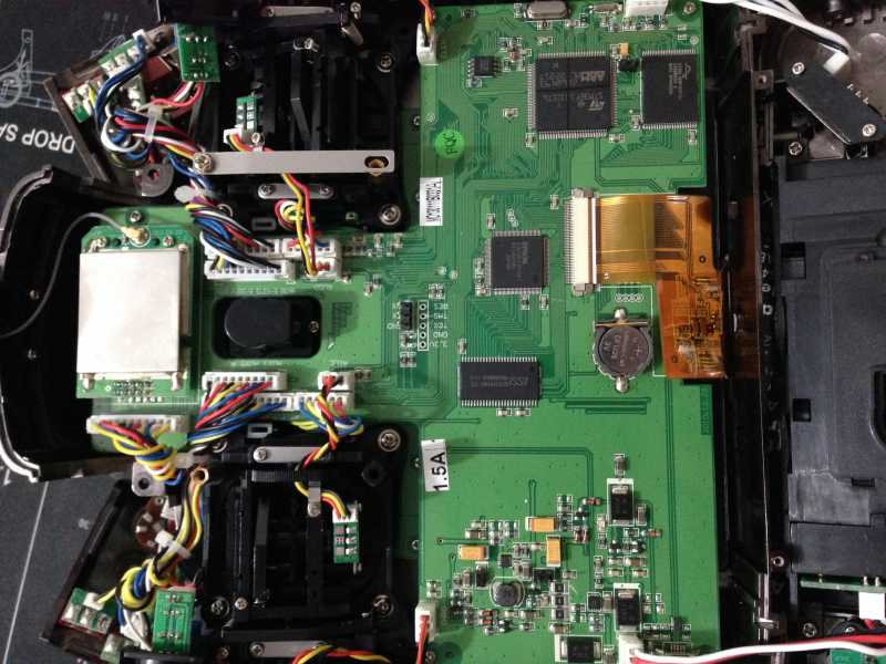

I just opened my 12s any help?
I saw this radio uses this flash www.digikey.com/product-detail/en/STM32F.../497-6442-ND/1852092
has a jumper beside someone already tried to make a flash with it jumpered? What does that jumper? zero setup? I've seen that has a connection jumper, straight to Flash ... someone could give a hint? Thank you!

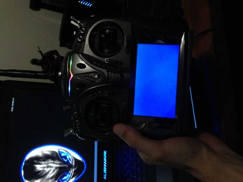

hello friend, thanks for answering, already tried to install the 4.0.1 version my radio, but he's a blue screen every time I turn, now when I try to install the factory firmware, it gets black lcd no light, and only with a light from power on (red light). The only firmware that it works and I have access to the software and the USB mode to copy the files to the root system, the deviation is 3.0 firmware only one that works on my radio, all others fail ....
I opened the radio to see if he had any electronics problem component, all measures are all no problem ...

What I am failing to understand is that if I download and install the 3.0 bypass it all works, if I try to install the 4.0 deviation, ja my radio does not go over the USB mode to copy the files to the root system. .. simply gives a blue screen ... When I try to install the factory firmware, downloaded by the Walkera site, or blue screen is simply not turn on the light only red light on power connecting. I downgrade to the version 3.0 standard deviation works ...

Hello friends, I did a test now here on my radio, I'll tell you what I did ...
1st pass the firmware by Dfuse
2nd Libray
3 Hold ENT + Power button to enter Download Mode to copy files, the problem starts exactly th ...
4 blue screen of death, I can not any more, not open USB
5 Back to deviation 3.0
6 Do all of the above
7 My radio works ... I do not understand!

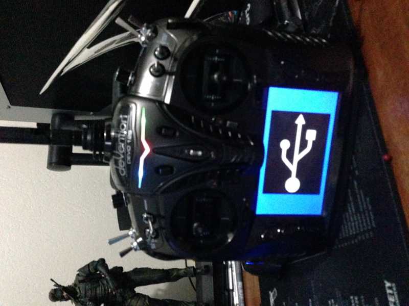

Replied by cristofer20 on topic Foto do Problema nas versão desvio 4.0
This photo is just to certify that you guys in 3.0 works fine!
Deviation 3.0 USB mode works perfectly
