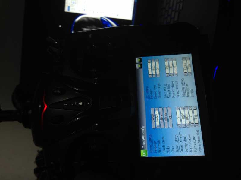

01 Feb 2014 19:32 #19613 by cristofer20
Replied by cristofer20 on topic Problema serio no DEVO 12s
henkerhaus wrote: Let's hope you have better luck with the new one! :)
Hello to all friends, I am back after waiting to get my new radio, I'm just here to thank the whole team and forum users for helping me when I needed. Now with my new radio all went well and I managed to put the firmware on it without diversion problem, really was a hardware problem, I just did and am very happy following the photo of my new radio firmware deviation! was first with no problem, thanks to all, I made a point to come thank and show who really had malfunctioned in the old radio! Thank you friends! Sorry for my english ... laughs ... 8-)
