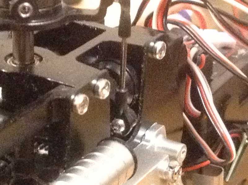

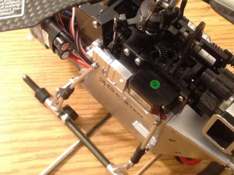

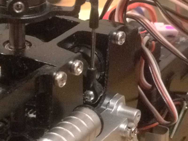

now it looks that all the cyclic servos need to be readjusted...they are all way off centre (negative) and there is hardy any travel on all three. If I recall I had to re-centre the cyclic servos with the stock firm ware when I set the transmitter and receiver to use the fixed id. Is this normal?

You shouldn't have to adjust anything on the helicopter after installing the deviation firmware. It sounds like you have a setup problem in your model ini file or maybe an incorrect setting in the transmitter.
Also make sure your trims are all centered and calibrate your sticks.

It sound as if you have a heli setup issue. Normally the servos should be centered when pitch, aileron and elevator output channels have the value 0. If this is not the case, you should work on the mechanics to correct this (and make only the last very small corrections with subtrim). The fact that you had do do this with the stock firmware too tells me that the problem is not the software.
