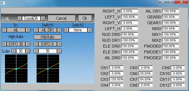

Too much servo throw you need to turn down the DR.
See these pictures.
The first picture has 100% servo throw (Scale: 100)
The second picture has 50% servo throw (Scale: 50)
Scale is your Dual Rate setting. Turn it up or down as needed.
The Expo tab when you click it will let you adjust how much if any Expo you want.
These settings are:
Picture 1
AILE D/R = 100% EXP +30%
AILE D/R = 100% EXP +0%
Picture 2
AILE D/R = 50% EXP 30%
AILE D/R = 50% EXP 0%

See these pictures.
These settings are:
Picture 1
Picture 2
