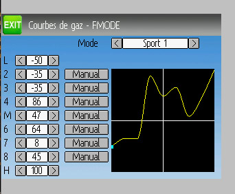

Hello
Testing in the emulator and editing the model code I have found that smooth=1 works for a throttle curve (and I suppose on a pitch curve) on a standard setting for an Helicopter.
wouid it be possible to add this possibility in the gui ? That would be great
Hereunder a snapshot of the emulator screen. The curve is just to show smoothing.
Regards
Morlacus
Regards
Morlacus
28 Jan 2016 16:10 #42326
Replied by mwm on topic Throttle & Pitch Curve Auto-Smoothing?
It's already in the GUI - you just need to use the advanced GUI rather than the standard one.
It can be added to the standard GUI - use the "Bug Tracker" link on the left to open a feature request for it. However, I wouldn't expect it to happen very fast, as I don't think any of the developers use the standard GUI, so it doesn't get a lot of attention. Probably faster to do it yourself, even if you have to learn to program first.
