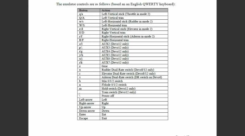

Is the Devo 8 emulator the closest one for emulating the Devo 6?
How do I simulate stick inputs?
Is there a manual or list of keystrokes?
Can the right-hand side of the window showing what I assume is debugging info be eliminated (for the purpose of taking screen shots)?
01 Feb 2014 19:42 #19615
Replied by rbe2012 on topic Emulator Basic Questions
(1) Yes.
(2) q/a, w/s, e/d, r/f are the sticks, Q/A, W/S, E/D, R/F the trims, the switches are located at the keys zxcvbnm (not sure which is what, but it is shown in the input monitor).
(3) Not as far as I know.
(4) As always: it is just programmed so the correct answer would be "yes", but this is something only a programmer could change. So for the user the answer is "no".
There is an emu for Devo6, but it is not published. I have compiled one with the actual code base (01/02/2014, 20:40 GMT-1) for you (guessed you're using Windows). You can use it with the Devo8 file system.

01 Feb 2014 19:54 #19617
by RandMental
Replied by RandMental on topic Emulator Basic Questions
In the Devo Manual is a list of keystrokes

01 Feb 2014 21:46 #19636
Maybe I should read the manual... it's a long time since...
