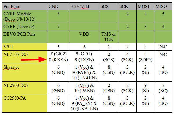

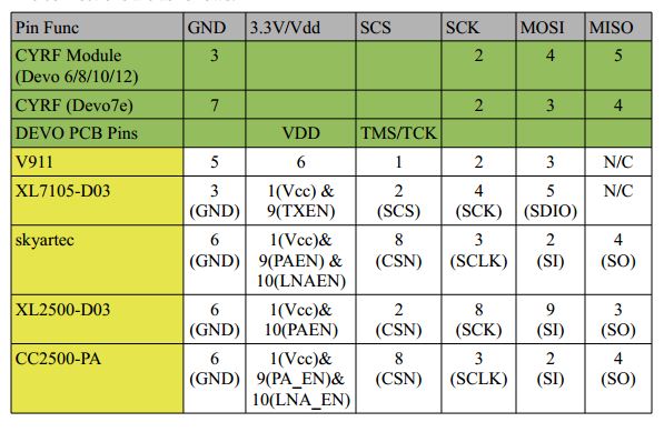

22 Jul 2014 15:50 #24752
by christx
Replied by christx on topic LCD remaining blank on my devo7e
i m going to try one more time the soldering of
an XL7105-D03 module on my devo 7e.
i found two arrays (they are posted in this topic as 1.jpeg and 2.jpeg), what would be
the best for my configuration?
thanks for your attention.

22 Jul 2014 21:45 #24755
by aMax
Replied by aMax on topic LCD remaining blank on my devo7e
Picture 1 works for 4.01 & nightly, but the module will not be put completely to sleep. The TX draws over 100 mA more.
With the nightly take picture 2, but....there is GND missing!
In short, picture1 but bind on module 6 to 9 and 7 to 8....no VDD to 9 !

30 Jul 2014 17:11 #24912
by christx
i made a new array gathering informations from different sources
i hope it will work for my devo 7e and deviation 4.0.1
this array is in the attached pdf file
if you see errors please tell me before i try soldering!
thank you
thank you
- aMax
- Posts: 776
30 Jul 2014 19:19 - 30 Jul 2014 19:52 #24917
by aMax
NO..........
Your pdf is for the Nightly Builds.
For Deviation 4.0.1 use the old wiring, where pin 9 (TXen) on the module is connected to pin 1 (VCC/ on module)......and pin 3(GND) to pin 8 (RXen)
