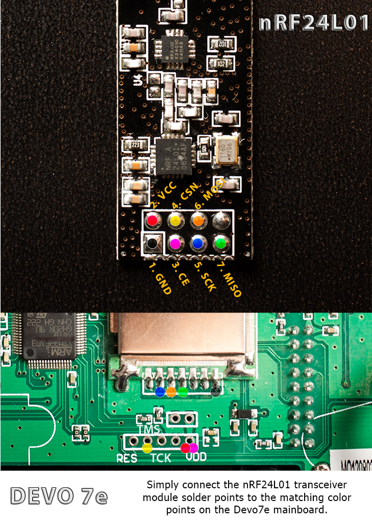

don't see anything obvious wrong with your tx.ini or your model file. Can you take pictures of your module install to ensure it is wired properly?

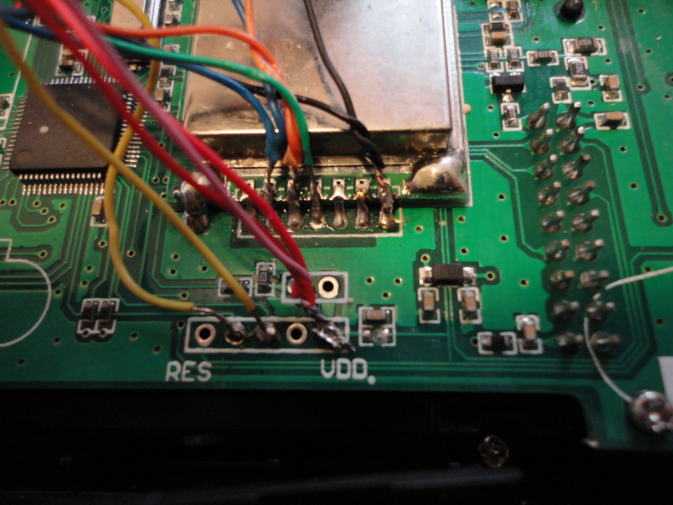

second pic is both A7105 module and nRF module together. The PCB on the Tx
the wires are heatshrinked to the module so a photo would not be useful but it is identical to the photo in hack mod page.
TMS yellow wire goes to A7105 module, TCK yellow wire goes to nRF module.
VDD has both wires to the modules including a pink from the MISO from the nRF

MISO of the nRF module should be connected to MISO of the CYRF module.
CE of the nRF module should be connected to VDD.

I think they are.
The VCC(red wire) and CE (pink) wire are together with the red 3.3v from the A7105. There are 3 wire going to the VDD.
The MISO on the nRF is attached to the 4th pin from left, well from the right as well.

I just double checked the wires and they seem to be correct. I knew the A7105 module went too easy!
