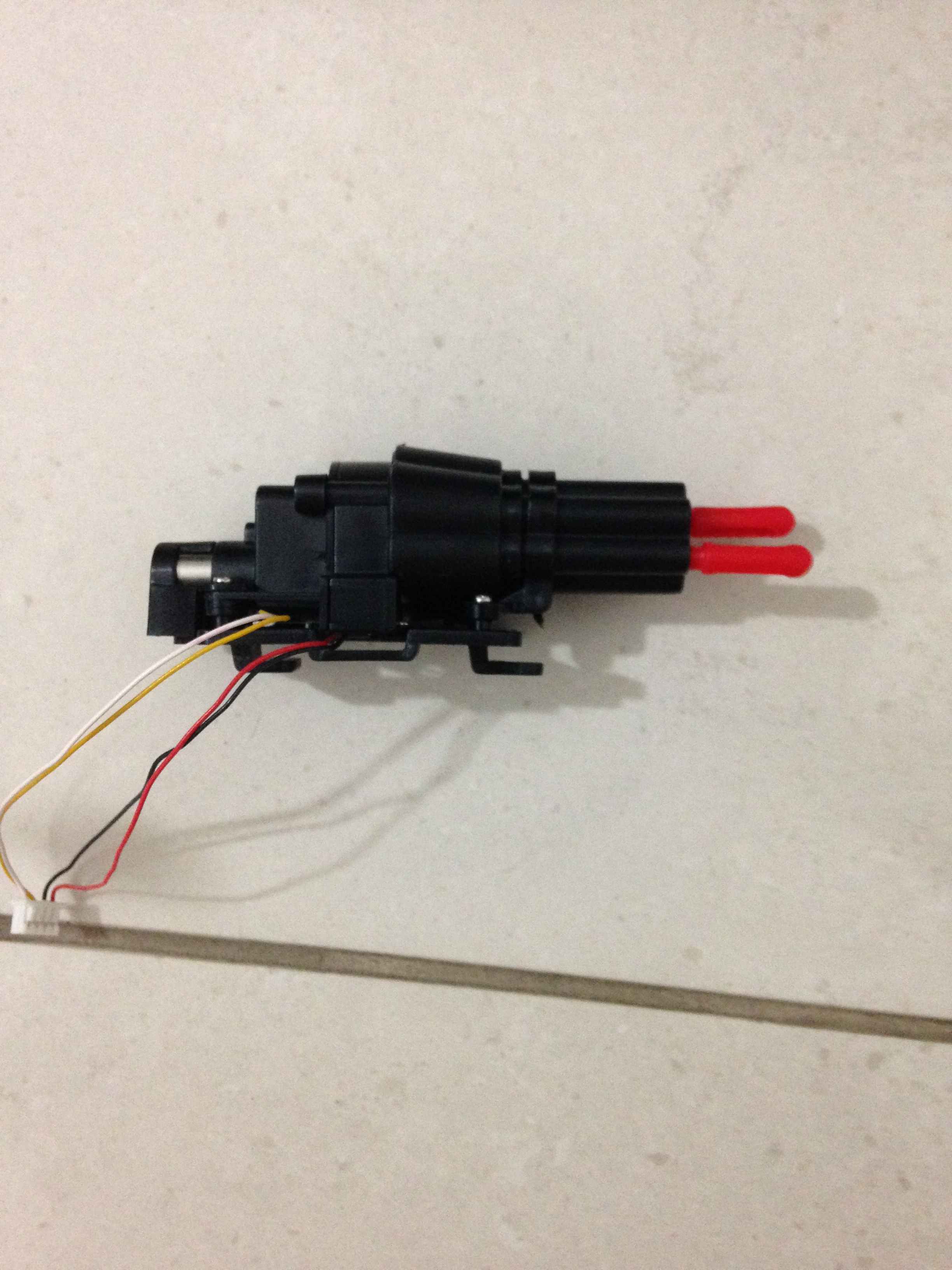

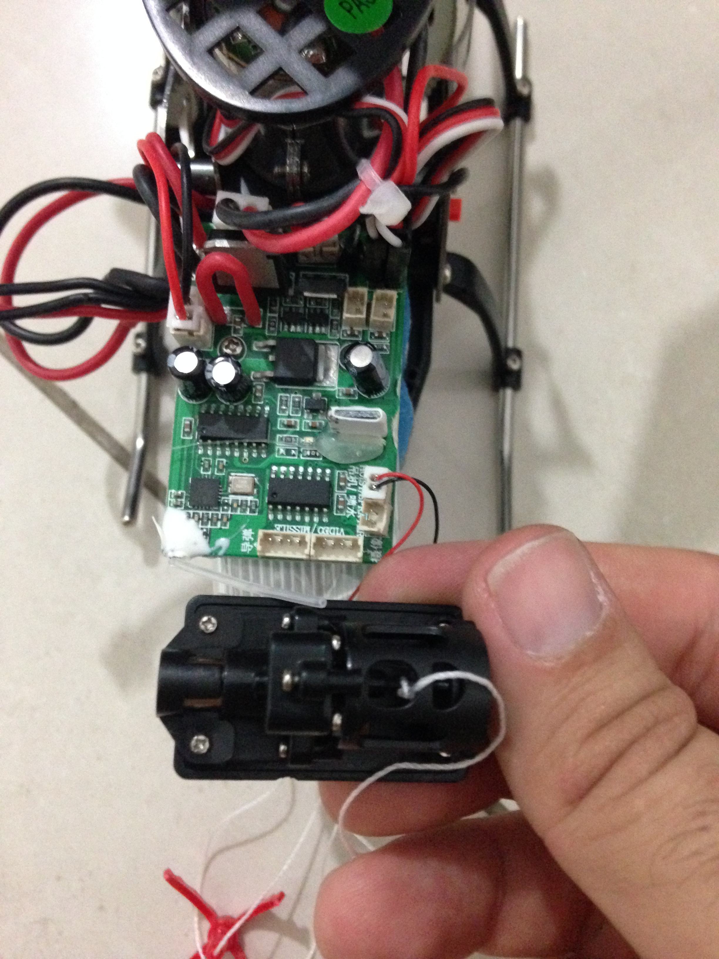

The new V912 came with a new board with support to video and other things like water cannon, rocket luncher. I would like to use my Devo 12s to active this accessories, but I couldn't. Tried to use channel 5,6, 7 with no help. I have tried use WLToys V9x9 protocol without success too. Anyone has a idea? thanks. I'm sorry for the bad english.
PS. Add pictures of the board and rocket launcher.
