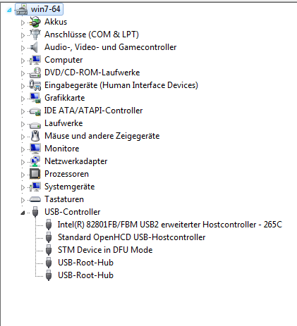

You didn't tell us your Host OS, leaving some guessing to us - anyway:
- Do you see the "STM Device" in Device-Manager in your Win7 guest VM?
It should be somewhere in the USB - section
- Did you assign the "STM Microelectronics STM32 DFU" device to your VM in VirtualBox?
Replied by linux-user on topic Can't detect my Devo 10 from Dfuse USB
alfmateos wrote: Hi, I'm running Windows 7
How can I get it to it detect it? I'm running my W7 on VirtualBox as a virtual machine, but my USB ports work just fine...

Hi linux-user, thanks a lot for answering! My Host OS is Mavericks (OS X), and I don't see the STM device inside the USB-Controler tree. Also, When I try to assign that device to my VM, I cannot assign it, it says that is already busy.
I set that device into the USB Filter first before starting the VM, but I think I tried almost every combination: setting the device into the filter and then trying to set it as you suggested, removing it from the usb filter and trying to set it as you said again... with no success.
I can click the STM device but it doesn't say anything, no message at all, and the the device is not selected. Then, when I try to select it again it says it's busy.
Is it that maybe I should remove vmware additions? Because it adds more USB devices, as the integrated webcam, or the integrated infra-red sensor that come with my macbook.
Or is it that I should try to install the driver manually? I don't know how, I tried to double-click almost anything inside the "Driver" folder that is inside the uncompressed folder of Dfuse...
Thanks in advance... I wish you give me the solution....
