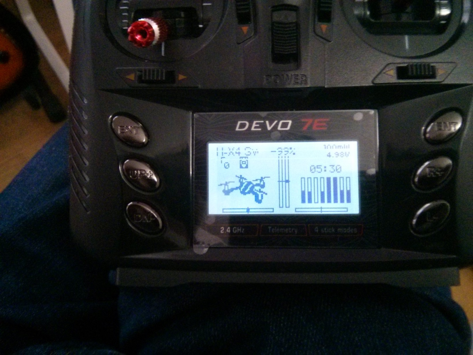

Hi guys, I've been using my Devo 7e without problems but today when I've turned on the radio I can see a blank line/s in the top of the LCD. I remember reading something about that problem but I can't locate the post... Any ideas?
BTW:I've upgraded to the last nightly and the radio stills showing off the problem....
Thanks in advance.

Looks to me like the column driver is failing. I'd be very surprised if there is anything that can be done about it besides replacing the LCD.

Almost 100% sure this is not related, but I'm getting lines on my Devo12... I'm going to go back to an older firmware just for giggles... I really have to think it's me opening the TX too much, but you never know.

Hi Hexperience, Please try it and post the result...I wonder if i can fix the problem whithout changing the LCD...
