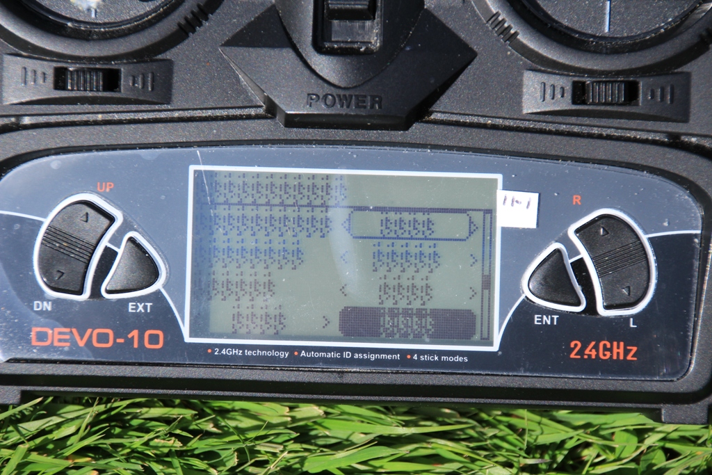

14 May 2014 19:24 - 14 May 2014 19:26 #23233
by FireAngel
Replied by FireAngel on topic Deviation software errors txt
Last edit: 14 May 2014 19:26 by FireAngel.
14 May 2014 21:19 #23238
Replied by PhracturedBlue on topic Deviation software errors txt
Does that go away when you reboot or not?
It definitely looks like some sort of font corruption, but I have never seen that with 4.0.1.
One thing you should do is to open errors.txt in a text editor and delete all lines then save it (don't delete the file). Then if Deviation crashes, it will fill in the errors.txt and you'll have a better idea when it happened.
Are you using Deviation in English?

14 May 2014 22:08 #23240
by FireAngel
Hi PB,
Since the last occurrence a few weeks ago I've had 40+ flights without a problem.
I used Notepad++ to delete all lines, there was nothing wrote in the error file this time.
Yes,I am using Deviation in English.
When I power off/On it reverts back to normal and works fine.
