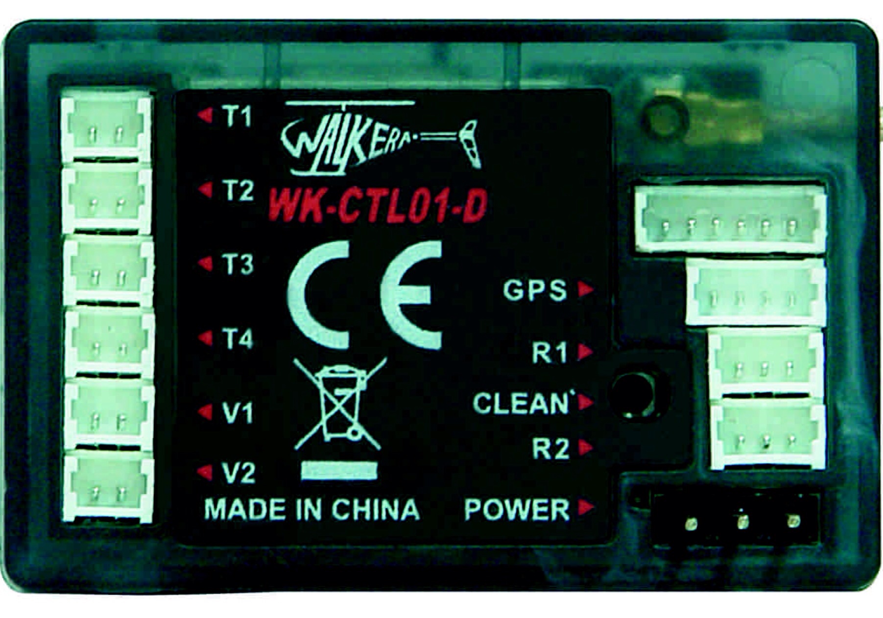

Hello
Can someone tell me what are connectors types on CTL01-D ?
Actually I would like to use the telemetry module to monitor my Lipo voltage but I do not find where to buy this cable ? ( from eBay or online HK shops )
It looks that connectors are balance JST connectors, aren't they ?

I doubt they are balance connectors, 'cause IMO they are smaller then that.
Look at this thread:
www.rcgroups.com/forums/showthread.php?t=1493712

Connector is Molex PicoBlade. They are used in many micro batteries.
www.hobbyking.com/hobbyking/store/uh_vie...m.asp?idproduct=9727

If i want to monitor a LIPO voltage, should i simply buy one of these cable and connect it to the Lipo battery ?
I also did not find where i could buy temp sensors for this telemetry module.

The module comes with 2 of them and 2 temp sensors when you buy it.

I bought mine on Ebay and it did not come with any sensor.
If i want to monitor a voltage, should i directly connect the 2 wires cable from the telemetry module to the voltage source, or this requires a specific sensor to do it ?

Directly connect to voltage source.
