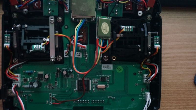

31 May 2014 04:42 - 31 May 2014 05:07 #23775
by scooterrider
Devo8s module development. was created by scooterrider
Last edit: 31 May 2014 05:07 by scooterrider.

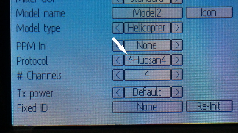

What should I do?
- jesmail
- Posts: 56
31 May 2014 15:16 #23789
by jesmail
Replied by jesmail on topic Devo8s module development.
If you are using the released 4.01 go into the transmitter as a hard drive. Then open tx.ini and remove the ";" in front of enable-a7105=A13 and remove ";" in front of has_pa_a7105.
If you are using the nightly build then do the changes in hardware.ini file.
- scooterrider
- Posts: 7
31 May 2014 15:50 #23791
by scooterrider
Very thanks~~!!
Work well~~!!
