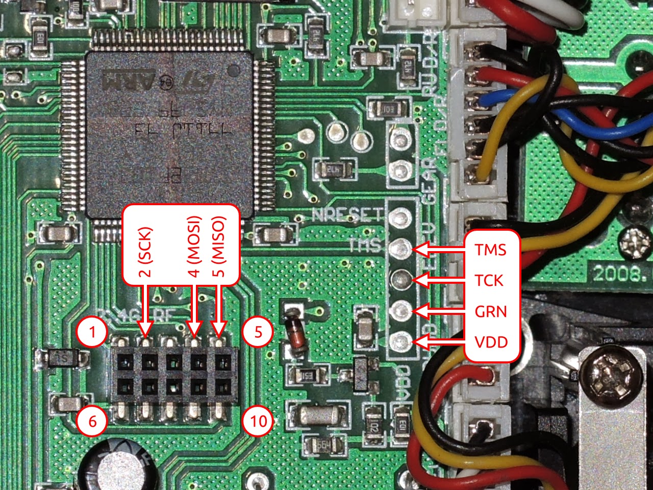

I see a lot of guides on how to add NRF24L01 support to the DEVO 7e, lots of wiring guides with pictures but I do not see anything on the DEVO 10.
The board doesn't actually show what pin is what *well partually*

Replied by victzh on topic NRF24L01 on the DEVO 10
First, you bought wrong module. Many eBay sellers to enhance visibility put in as many related terms as possible. In case of modules, the first name is the real one, all others are visibility boosters.
Second, the instructions are easily searcheable, e.g. terms 'devo 10 nrf24l01' give you this image in the first page of Google image search:
4.bp.blogspot.com/-I6pqIy94bEc/UntgBoyRq...EVO10-PCB-pinout.jpg
This nice picture can be used with existing instructions on this site:
www.deviationtx.com/user-manual/Document...uleInstallation.pdf/

Replied by Joeboo25 on topic NRF24L01 on the DEVO 10
This should make it pretty clear:
www.massiverc.com/PrestaShop/en/333-15-c...h-2x4-connector.html
This one has a little more detail as well, but it's in Russian. Chrome translate works pretty well:
mcheli.blogspot.com/2013/11/deviation-hisky-module.html
