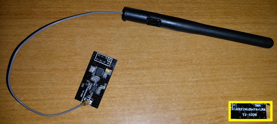

Both need to install the nRF24L01+PA+LNA ..... and good news, both protocols are already supported by the last BN. The car is using the V202 protocol and the Heli, the ESKY150 protocol (not tested yet, at 99% should work)

you mean this?
www.banggood.com/CC2500-PA-LNA-Romote-Wi...F24L01-p-922595.html
or this?
www.banggood.com/2_4G-NRF24L01-PA-LNA-Wi...ntenna-p-922601.html
If not, could you please link me the items I need?
Can I install it with next to the V911 module or I need to remove it?
Please give me some instructions...
thanks,
bm
24 Jul 2014 21:23 #24782 by SeByDocKy
Replied by SeByDocKy on topic Esky F150 Airwolf; Wltoys A979
More this one with the antenna .... (if you don't want to install an external antenna)
www.banggood.com/DEVO-Transmitter-Tuner-...ys-V922-p-89812.html
Yes you cans install a second module while keeping your A7100. Instructions can be find in User manual section I guess

SeByDocKy,
I receved the module (11 calendar days....WOW!)
Could you please explain me in a few lines how to install it as a second module? What pin goes where? I have a D10.
My v911 module is on "enable-a7105=A13". It was a long time ago when I opened up the Tx last time....

You can find all informations at
bitbucket.org/PhracturedBlue/deviation/wiki/Devo8ModuleInstall
and
bitbucket.org/PhracturedBlue/deviation/wiki/ModuleInstallation
16 Aug 2014 14:36 #25217 by billmester
Replied by billmester on topic Esky F150 Airwolf; Wltoys A979
OK, done. I've done the install and the TX boots up so far, so maybe I've not ruined too much things :)
