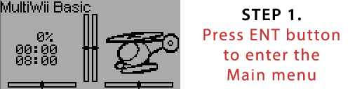

27 Jul 2014 03:57 - 27 Jul 2014 03:58 #24823 by Daryoon
Replied by Daryoon on topic Devo 10, Phoenix & Throttle Hold
I think it'll be easy to make it work the way you want it to.
I don't understand how you want Throttle Hold to work?
I did a GIF sequence to help a person add Throttle Hold to his Devo7e. Same steps will work for the Devo10. You simply choose the switch you want to activate.
It was for a DSM2 quad. So throttle was on Channel1.
Since yours is on Channel3. Simply select Channel3 instead. Then activate the safety value and switch that will activate it.
Last edit: 27 Jul 2014 03:58 by Daryoon.

27 Jul 2014 06:32 #24834 by Daryoon
I said that animated GIF is for a DSM2 model. So the throttle channel is on 1.
For you, it would be on channel 3. Same concept.
You can choose whatever switch you want to activate to enable throttle hold. Who cares about standards. Do what you want.
All the info on how to accomplish what you want has already been said. Hopefully you can reread it. Try it out. And get it working.
Good luck.
