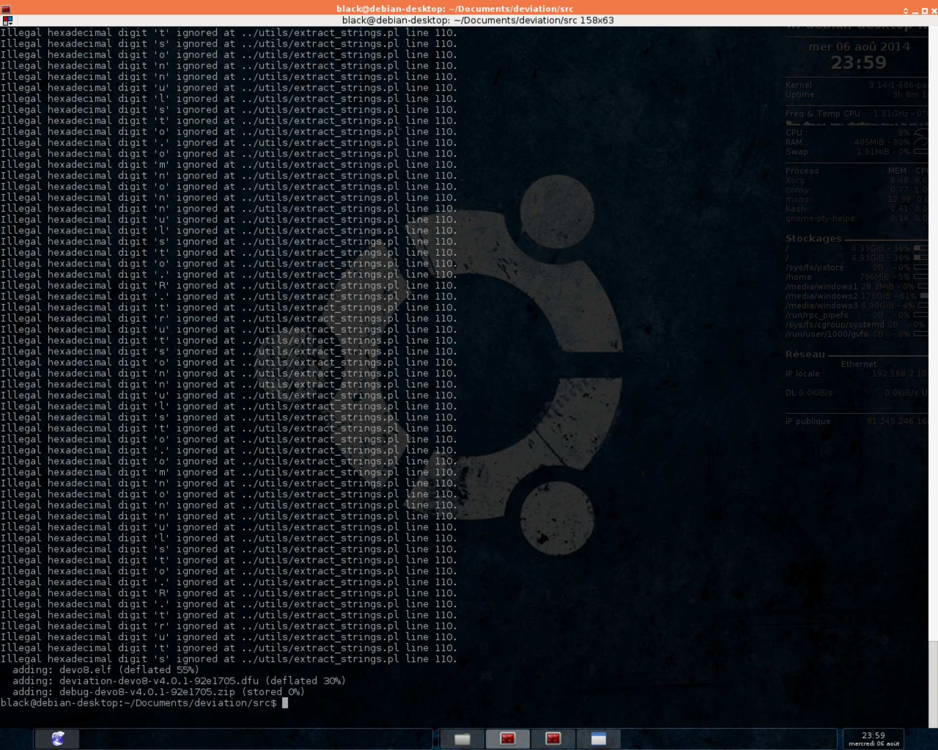

Building message "illegal hexadecimal digit" was created by blackmoon

Tried to reproduce on Xubuntu 12.04 using 2352:92e1705cf895, I'm not getting this issue. Perl script does not look like it have been touched too recently at this part (December 2013), entire script was touched last in 2331:6d04f052e8b6 (Jun 30).
Can you please check if problem exists with 2331 ? And please check if you've updated some perl-related stuff within your system in the near past - I had such issues (not with deviation) from time to time on ubuntu after updating packets.
As far as I understood the code, its checking which strings found in source code are contained within object files, and thus need to be covered by translation (to reduce binary size). And when I recall right, Devo 7E does not support translations due to flash memory limitations, that's why you're not getting this issue there.
Concluding, this should be no problem for you when english text is fine for you (not sure if that issue has any effect besides annoying printout at all ...)
Nevertheless, PB should double check if this does harm anything.

I just did a dist-upgrade from Debian Wheezy to Jessie, maybe it's related. I was trying to make a devo8 build with your patch for nusbr in the MM thread to see if it could help him, there are only 7e and devo10 builds there.
Anyway I'll revert to 2331 and test it, if no joy, then look into the perl stuff, thanks.
