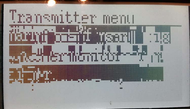

17 Aug 2014 10:31 #25235
by billmester
Replied by billmester on topic FW upgrade - TX not seen in DFU, only as USB drive

Did you also copy over the filesystem? If not, do that too.
Yes - got it now. Do not now, what happened 1st time...
