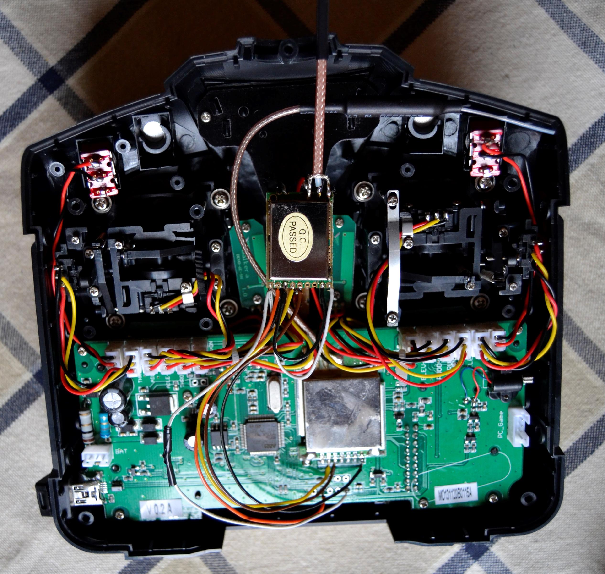

hello,
i have doubts about some informations contained in the file "moduleinstallation.pdf"
in particular about the array of page 10.
For a XL7105-DO3 and a devo 7e it seems (from other sources see picture attached) that pin 3 and pin 8 on the module should be linked together.
thanks for your attention.
Christophe

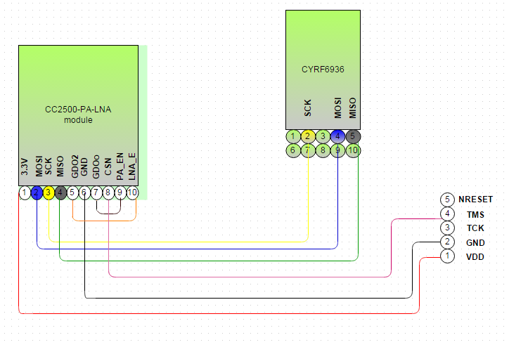

I've an idea
If I draw a schema for this connections you may take a look, validate (or not) the schema and so this discussion may become more usefull for the others that, as me, have to do this mod. In the net I don't find pictures on Devo 10 connections, only on 7 or 8.
Are you in accord with this?
the important thing is that now I have the right informations and some of my doubts are more clearer.
I thank you for the suggestion about the universale module, but as I said, for now I don't need this because I have only 3 heli at the moment: 2 with specktrum protocol and 1 with skyartec. In the near future I would like to have a the Assault 450 from HK that have an Orange receiver with the same specktrum protocol.
I've an idea

16 Nov 2014 21:20 - 16 Nov 2014 21:22 #26432
by auceto
Replied by auceto on topic moduleinstallation.pdf still up to date?
Last edit: 16 Nov 2014 21:22 by auceto.
- tammo
- Posts: 1
19 Mar 2016 21:14 #44838
by tammo
Replied by tammo on topic moduleinstallation.pdf still up to date?
Hi
Can anyone confirm if the above schematic is still valid for the latest nightly build? I'm addding a CC2500 module to a Devo 10.
Thanks!
Thanks!
19 Mar 2016 22:02 #44840
Replied by mwm on topic moduleinstallation.pdf still up to date?
4.0.1 and the nightly build use different connections. I'm not sure the PDF in the title is up to date for the nightly - I'm not sure it has the CC2500 connections.
Click on "Links" on the left, then click on "Module installation" for the official module installation guide. It doesn't have a pretty diagram for that specific CC2500, but does have pin layout diagrams and wiring instructions for all supported modules.
