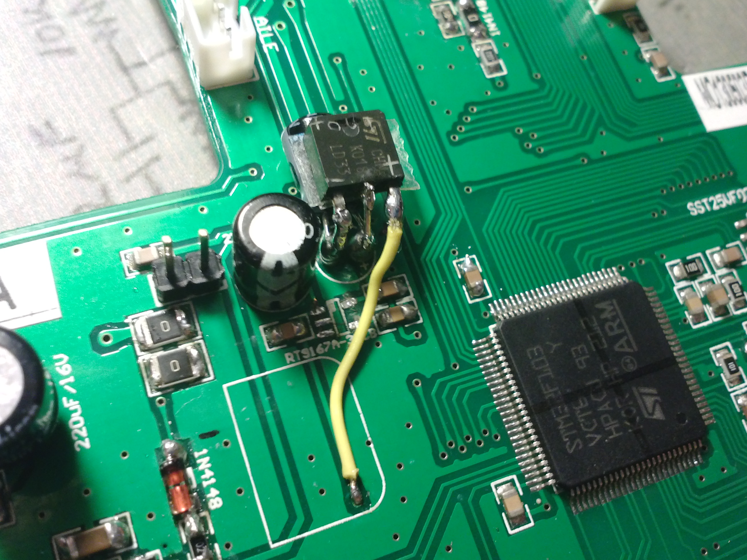

hello. suddenly my DEVO 8S does not turn on anymore. without any reason. I never updated, I never fall to the ground. now no longer turn on. The display is turned off, only the red LED will light for a moment. from what could be the problem?

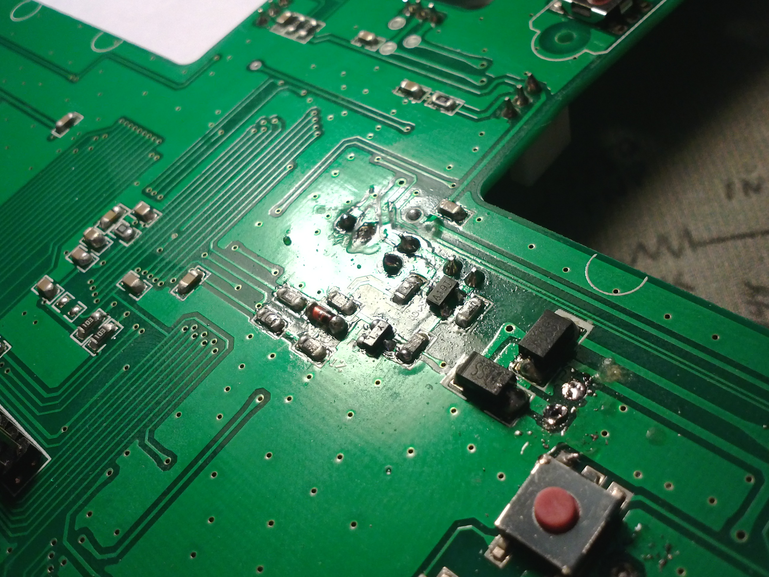

finally, after 2 evenings are managed to fix it. of course was not a simple switch defective or low battery
. I had to replace the voltage regulator that power of the processor and one mosfet . not finding what exact I have put one a little bigger. so this time you do not break so easily.
