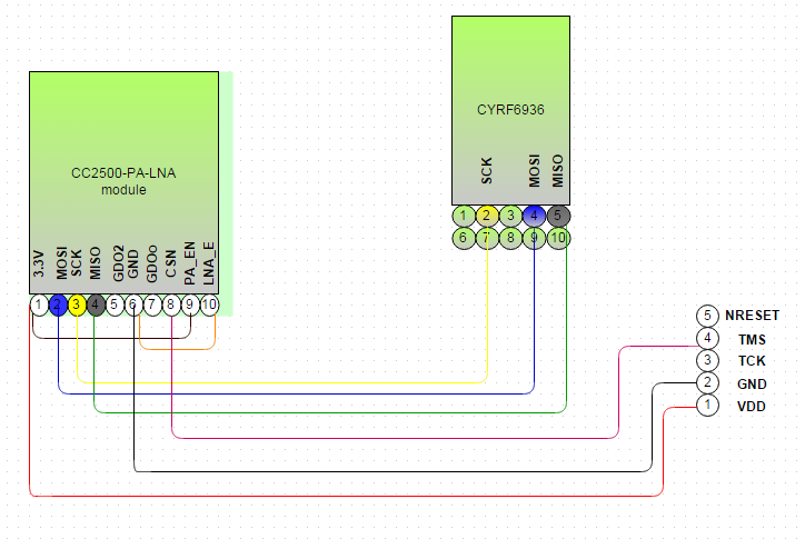

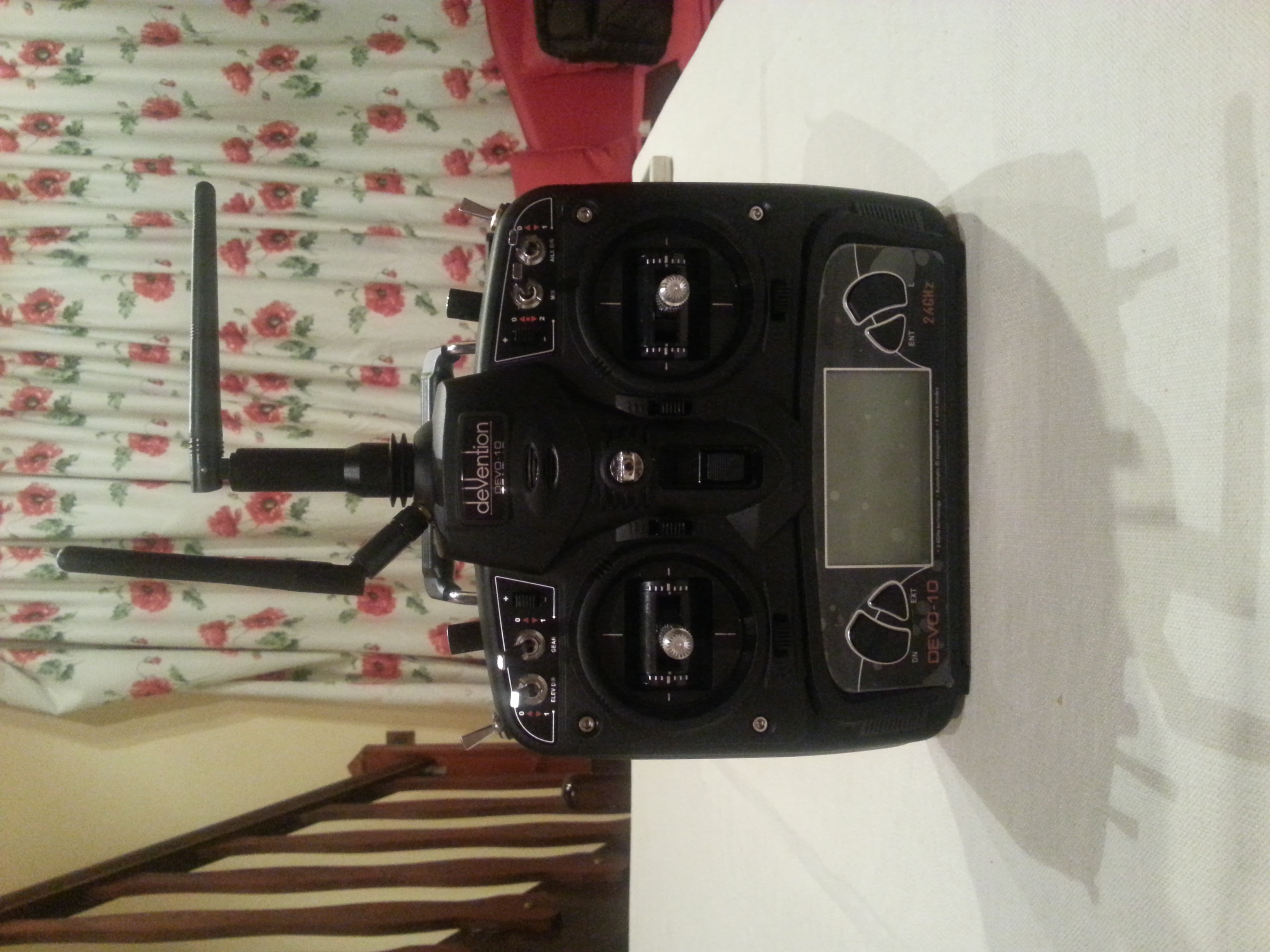

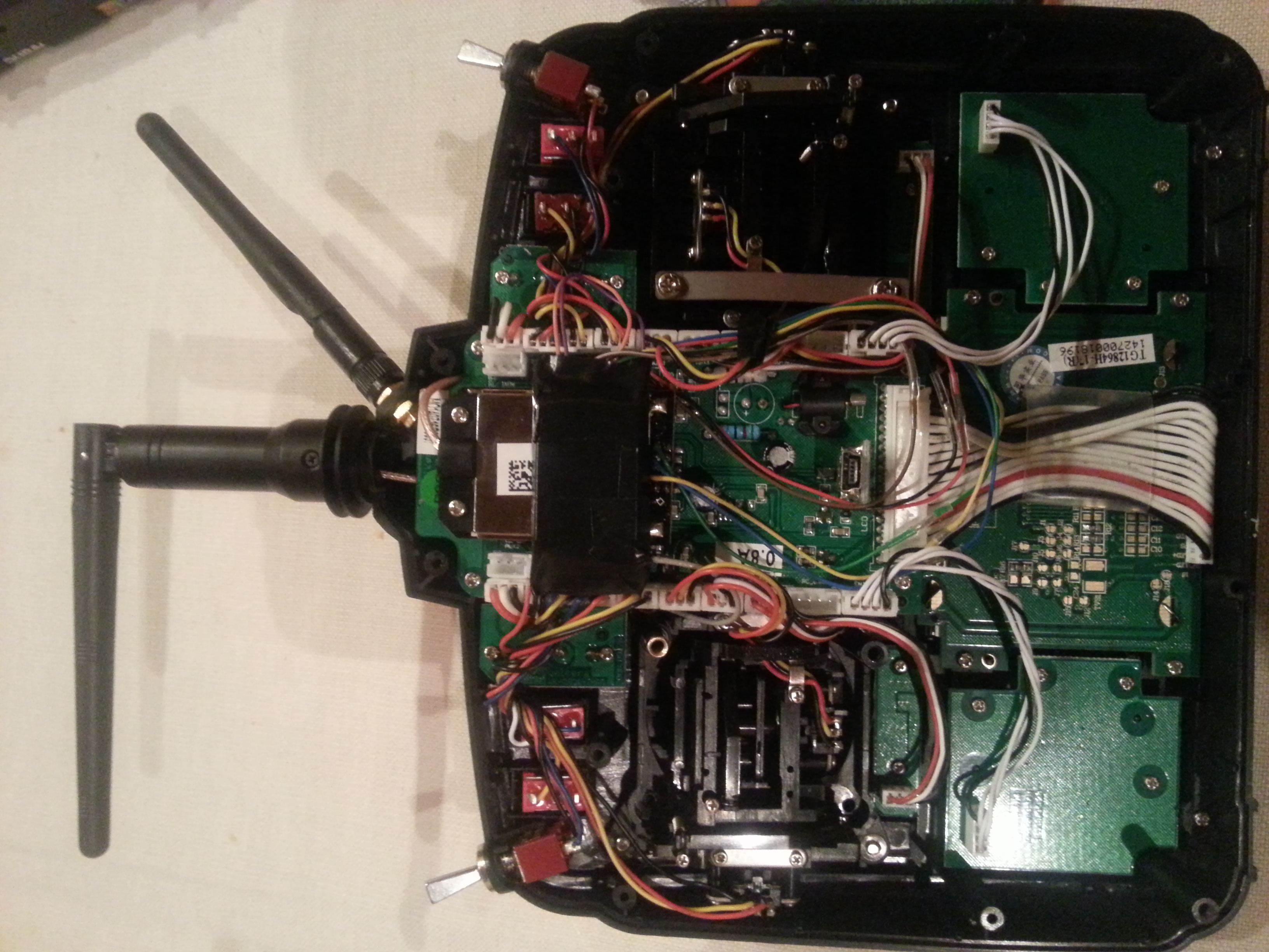

Hi at all,
I installed the CC2500 buyed on Aliexpress as the instructions say...for connection I follow the PB instructions on bitbucked site, and I mounted the antenna out of the radio on the left of the stock antenna.

this is my mod: if someone see something wrong...
At first all seemed ok but last week I notice this problem:
When the tx is very near to my Skyartec X3V (heli on the ground and radio 50 cm or less) and I rotate the TX on its axe, some time the rx lost the signal (red light is off and the heli do not respond) and than, if I walk away, the signal become stable (red light stay fixed).
I've tested the signal also walking (with trottle hold) in my home's rooms and I closed doors too, to create artificial "barriers": only in the room farthest the rx losted the signal (15 meters about from tx). The signal power was set to 100 mw.
So I ask: is it normal? is it normal when the tx is very near to the rx?
I think that the test that I done walking in my house, is normal that in some circumstance the rx loss the signal, considering that the walls may corrupt the reception; in open spaces this issue should not happen.
But when the radio is near!!!
Any suggestion to solve?
