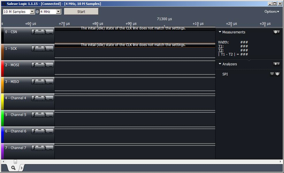

Got a screen shot of it and the error it is showing..

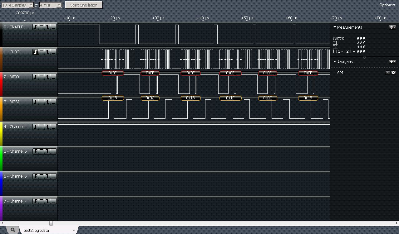

16 Dec 2014 12:58 - 16 Dec 2014 13:31 #27043 by aMax
Seem to me as if it completely broke.
Only the first screenshot was showing up resonable signal data.
--screenshotlogic8error.png-- , even though there was an error reported.
Post:#26798
All others have identical data on at least two signal lines. Looks as if
something is shorted.
Otherwise it is not possible that mosi and sck have identical data.
Does the dud nRF start working at the Devo8?
The last uploaded file:
The signals are there, but the CSN has to stay at low all the frame.
Last edit: 16 Dec 2014 13:31 by aMax.
16 Dec 2014 15:40 - 16 Dec 2014 15:51 #27044 by aMax
Is it possible you mixed lines on the analyzer?
I rearranged your last data and got this. Was it on powerup?
Last edit: 16 Dec 2014 15:51 by aMax.
