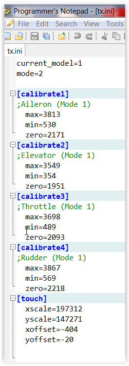

OK experts, I'm really scratching my head here! I have successfully downloaded the Deviation 4.0.1 and also a module to let me fly my WL Toys V911 amd 912. Amended the TX ini. file as instructed in the module notes and got a bind first time. Had to reverse all channels except the throttle but heli flys great. Much nicer feel than the cheap toy tx normally used.
Now comes the problem part. I wanted to update to the nightly build as my throttle and elevator were on the incorrect sticks when using DSM2 or DSMX. So I went through the update process choosing to replace the older files with the newer nightly version. All looked ok but when I went back into the TX ini. file to amend as before I can't see any module section.
So I went back to basics by formatting the TX drive, re-loading the original dfu file and the original deviation 4.0.1 build. What's odd is the TX ini. file still doesn't show any module section. OK, I don't really want to amend this as I imagine that the nightly build will feature a newer TX ini. file which I'll need to amend but where the heck has it gone. The only files I didn't extract to the TX drive were the dfu and debug file.

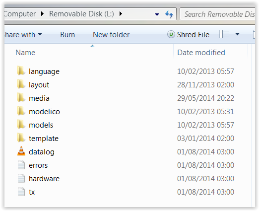

This is a screen shot of the TX drive contents and TX ini. file. What am I doing wrong?

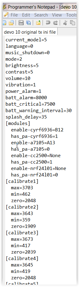

I did save the unamended TX ini. file (fw 4.0.1 build) which is a lot longer than the one presently residing in my Devo 10. I've also attached a screen shot of part of this file showing the modules section etc

in the nightlies, you need to modify the hardware.ini, not the tx.ini.

It is in the same folder (root), but in a different file: hardware.ini.
You do not have to change anything in tx.ini. When you calibrate your transmitter, the results will be written in the tx.ini. But when you use modules, then you have to change the hardware.ini
