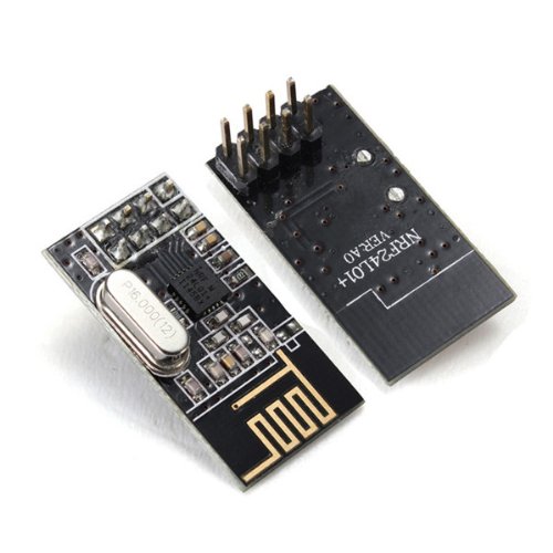

I have attached a picture of the module; notice tne name "NRF 24L01+", does the "+" matter ?

I am not shure but i don't think it has a power amplifier. However this module should work, as long as you don't fly to far away.

The module in the picture does not have a PA. Set has_pa-nrf24l01 = 0.
Are you sure the pinout on that module is the same as the ones on the website you linked? Looks like probably so, but good to be sure.

That link shows 2 different modules (Both NRF24L01) The first picture shows a module without PA and internal antenna, Like the one you have. The second one does have pa and need an external antenna.
just to be clear: VCC and CE both go to VDD.
It shouldn't matter but i use the ground pin between VDD and TMS, but that is personal.

I assume if your module is really this one...without PA
www.deviationtx.com/media/kunena/attachm.../807/51OyHRKDHsL.jpg
...you will not have much range. Pay attention.

Exactly this one . . .
Anyway, thx for the warning !
Since I'll use it only for small helis like this WLToy AS350 I hope it doesn't matter.

Should be fine. The V911 A7105 module was really popular because they came in the RTF Tx for the V911, and it has no PA. I ordered an A7105 & NRF24L01 for my Devo6S with no PA and the on-board antenna, excpeting to use them for indoor heli's and quads.
But always range test!
Replied by mwm on topic wltoys wl 931 as 350
Gerhard_H wrote: Exactly this one . . .
