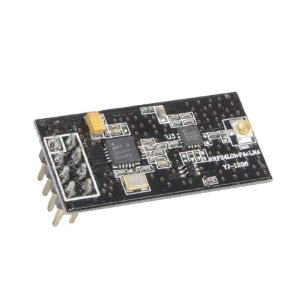

30 Jan 2015 20:09 #28255
by jjw_d7e
Replied by jjw_d7e on topic Syma X5C - 1 for Devo 7e
This is the module thats installed.
2.4G NRF24L01 PA LNA Wireless Module 16*32mm (from Banggood)
No + on the description, so that could be my problem.
Just refuses to bind, just sits there with the dialogue box "binding to X5C-1".
My JJRC H8C which uses the same module binds fine as does my Hubsan X4s using the A7105 module.
If then this NRF module is the problem and I changed it to the + module would it have an effect on my JJRC H8C?

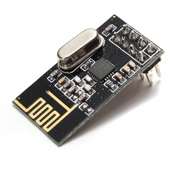

30 Jan 2015 20:35 - 30 Jan 2015 20:36 #28259
by jjw_d7e
Last edit: 30 Jan 2015 20:36 by jjw_d7e.
30 Jan 2015 20:45 #28261
Replied by hexfet on topic Syma X5C - 1 for Devo 7e
Yes, the module with the nRF24L01+ will fly the X5C-1. The first module shown has a PA (the second chip), so you would have less range with the module in the second pic. Modules with nRF24L01+ and PA are available.
Not sure about the pinout. Likely the same but best to check.
- aMax
- Posts: 776
30 Jan 2015 20:51 #28262
by aMax
Replied by aMax on topic Syma X5C - 1 for Devo 7e
The first module is the right one. Has a "+" chip on board.
Btw, the pinout of these 8pin modules are nearly "standart".
- jjw_d7e
- Posts: 19
30 Jan 2015 21:22 #28264
by jjw_d7e
Sorry aMax, are you saying the module that I've already got installed with the PA and LNA is the right one or the one with the built in antenna?
- TomPeer
- Posts: 303
30 Jan 2015 21:26 #28265
by TomPeer
Replied by TomPeer on topic Syma X5C - 1 for Devo 7e
That first module from banggood is a nrf24L01+. It is stamped on the chip.
- jjw_d7e
- Posts: 19
30 Jan 2015 21:29 #28266
by jjw_d7e
OK, so if thats the case it should work.
