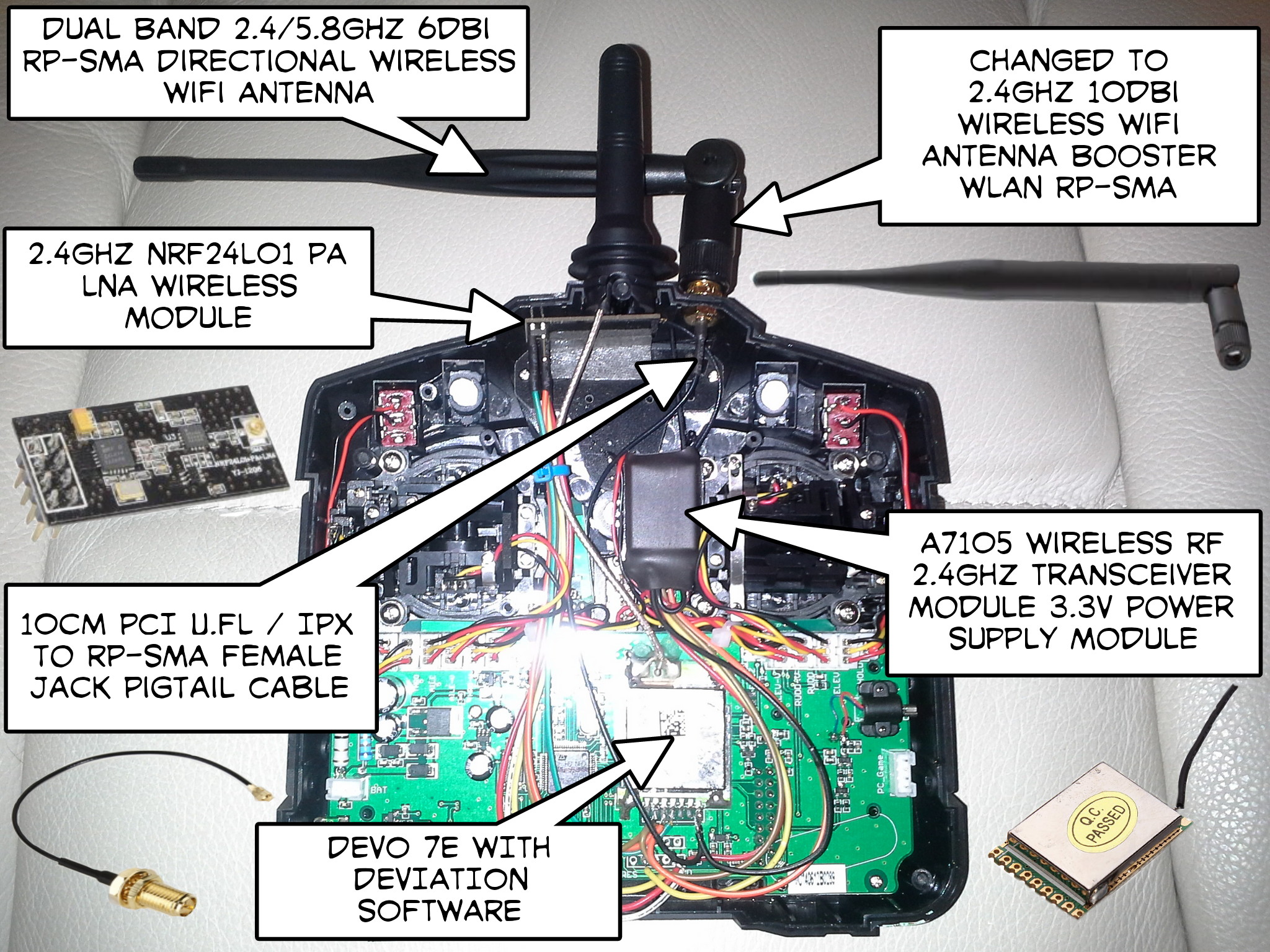

Thanks so much! Great looking setup you have there. Very interesting antenna. I thought the 10dB gain came at a cost of directionality, but the links I've turned up for similar looking antennas still claim they are omnidirectional. Once I have the RP-SMA connected to the NRF24L01+ module I should be able to experiment with some different antennas. Thanks again for the very clear photo (and neat captions!). Mine should arrive in 1 - 2 weeks.

03 Feb 2015 14:32 - 03 Feb 2015 14:36 #28380 by aMax
Replied by aMax on topic Syma X5C - 1 for Devo 7e
I have two of these dualband antennas, but they seem to have no more than 2dBi gain on the 2.4 Ghz band. Maybe only 6dBi for 5,8 Ghz.
Testet with a wlan router and a usb wlan stick and there was no gain at 2.4 Ghz.

03 Feb 2015 15:13 - 03 Feb 2015 15:14 #28382 by jjw_d7e
Replied by jjw_d7e on topic Syma X5C - 1 for Devo 7e
The only reason I fitted the duel band antenna in the first place was because it was recommended by someone who had modded their 7e using this type of antenna and as I didn't know any better I did too. I later thought why do I need a duel band antenna when I'm only using 2.4ghz so I changed it to the other one shown in my picture. I've not had a chance to try the new one yet at range due to, wind, rain, hail, sleet and snow, but hopefully I will soon.

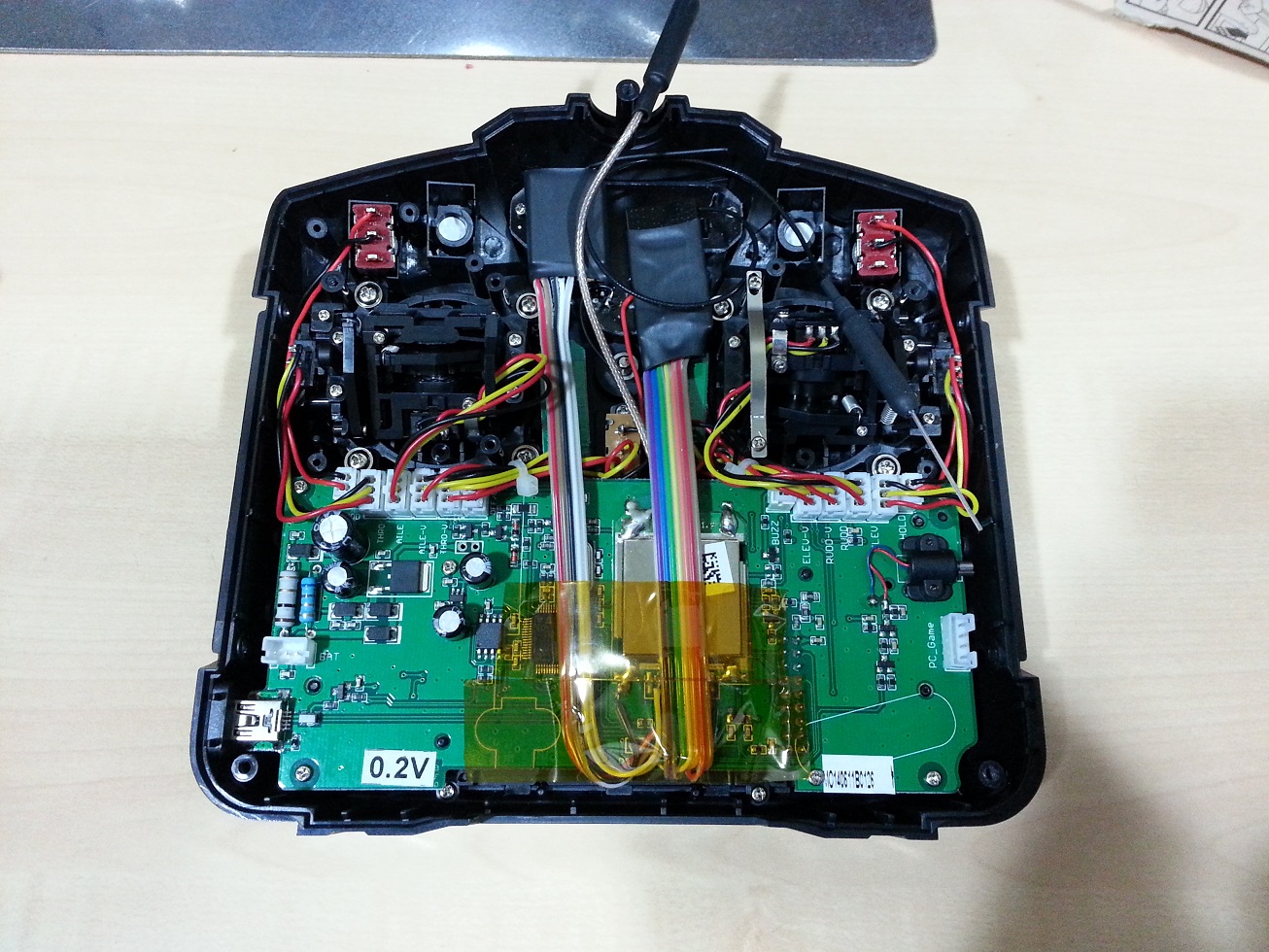

08 Feb 2015 18:59 - 24 May 2015 12:19 #28462 by Durete
Replied by Durete on topic Syma X5C - 1 for Devo 7e
DroneBee wrote: I've got Deviation installed (woo!) and will try to solder the NRF24L01+ module on this afternoon. There was some discussion of a new wiring protocol for the A7105 module, so three questions:
1) Is this tutorial still the best way to install the NRF24L01+ module for the X5C-1?
2) No need to worry about shielding for the NRF24L01+ module?
3) Then install hexfet's most recent .dfu to bind and control the X5C-1?
Thanks!
1) Yes, the tutorial from Daryoon is very good. He has very good quality photos.
Only one recommendation. Better bridge Pins 2-3 (VCC-CE) into the nRf24L01 module than solder 2 cables.
2) Yes, you don't need to shield the nrf24l01 module, but better install at the upper side of the Devo TX. I attached a photo of my 7E with nRf24L01 and A7105 modules installed. As you can see the better option is at the upper side of the TX.
3) Yes, these is the latest build with X5C-1 protocol, and Hexfet found how to Randomize the TX address, so at this moment is the best option. Don't need to worry if more than one guy are flying X5C protocol with Devo transmitters.
I tested these build 2 hours ago with my X11C without any problem flying about 1 hour.
