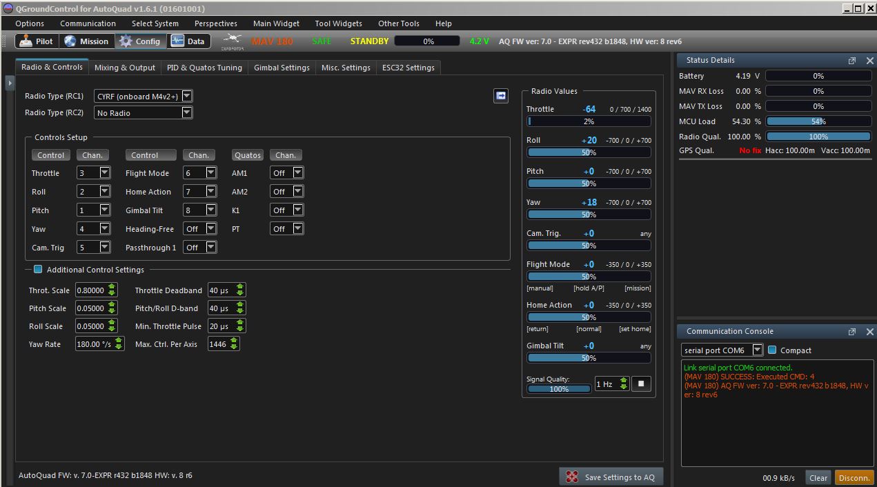

I've attached a screenshot of the ground control. Radio looks OK on that and it used to arm on these settings. Also attached the two model files from tx.. actually I'm on my phone doing this so I'll do another post with the attachments from my computer.

It's not clear to me from what you said, so does the ground station show the radio signals responding to stick motions? If not, then the problem is liable to be your Tx, even though it binds. Could be both Rx's going wonky at the same time. Can you borrow another Tx to test them with?

The ground control shows normal response to all stick movements and I've recalibrated the tx.
Protocols have been copied. I have a spare DSM2 receiver and the same thing happens with that one too.
When arming the quad the GC shows throttle at 2 to 6% (as in the screenshot I think?) and right rudder at around 86%. On the tx they are at -100 and 100 respectively. The thing is that this was the same when it was arming before the problem started. And would the two other receivers be affected anyway as they don't need "arming".
