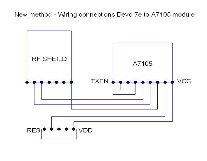

21 Apr 2015 03:25 - 21 Apr 2015 04:36 #31448
by Newman
Replied by Newman on topic Correct wiring for A7105 into Devo 7e
Thanks mwm I forgot to check the notification box for my initial question
. Since posting this I have managed to wire up my module as per attached diagram but just have a question if I may trouble you. I am using Deviation 4.0.1 with a A7105 wired the "new power saving way", Is it necessary to use the nightly build to optimise this connection method i.e. lower power consumption and some telemetry support IIRC. Seeing as the nightly built is, I am led to believe not as stable as 4.0.1, is there any problem with using the new wiring with 4.0.1. which is what I am currently doing and it is binding to Hubsan with no apparent issues. Thanks Pedro

21 Apr 2015 13:07 #31459
Replied by mwm on topic Correct wiring for A7105 into Devo 7e
IIUC, the new "power saving way" won't actually save power with 4.0.1. But if it's working, I'd not update to a nightly build. I don't recommend such unless there's something in them you need. The A7105 and hubsan protocol were pretty solid in 4.0.1.

22 Apr 2015 00:37 #31476
by Newman
Thanks for that mwm. Yes I think that I will leave well enough alone. It is just a little perplexing that plenty of people talk about this wiring but it can seemingly only work with the nightly builds which are from all accounts inherently unstable compared to 4.0.1. It will be nice is this is supported in the next release of Deviation in the future. I assume that telemetry in regard to battery voltage falls into this category too
