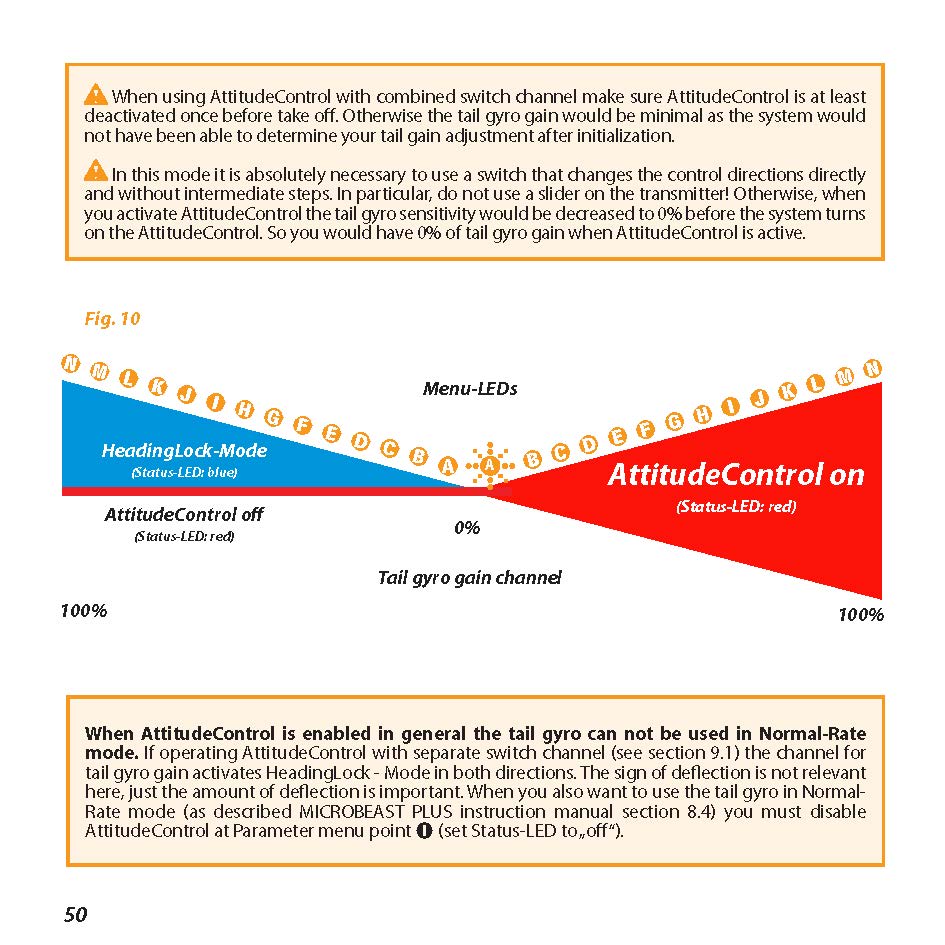

I am playing with the new beastX plus V4 has featuring "auto Stabilization".
I only know how to use the "Standard" interface on my 12S. I need to be able to assign a button to activate "auto stabilization". Can someone tell me how I would do this.
www.beastx.com/download/manual/microbeas...n_V4.0.0_EN_0715.pdf
Please see page 16.
Would you help me, please?

The beatsX guys have released a controller that will auto stabilize the helicopter in the event one gets into trouble. It creates a "horizon" and rights itself. it can do this with 5 different degrees of responsiveness or what they call "attitude". But, to activate it I need to dial in negative numbers on my gryo switch. That's how it is apparently activated. Via negative gyro. Opposite of Head lock mode activates it.
So, I'm not sure hot to activate, for certainty, however. But, I don't have negative it's 0-100. See page 50 if you would, please. I also sent the entire manual if you ever wanted to take a peak at more details.
So, if I have this correct, all I should have to do to activate the function is throw an assigned switch from HH (or is it rate mode) mode to position with Neg. gyro values and it activates the function? The more negative the more aggressive?

Go to the travel adjust menu and change the gyro to less than -100(-101 - -175). Go to gyro sense and change one of the switch positions to 0% or close to it. That should get you a negative gyro number.
