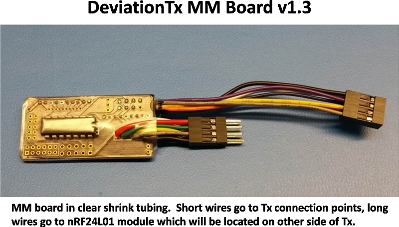

I soldered the lead wires on to the MM board that go out to the Tx. ...iron in contact with the joint for too long on a couple of them, melted insulation down the wire too far on the back side, and the alligator clip I used to hold everything in place while I soldered deformed the heat-softened insulation on the others :-/ Cut new wires and re-did. A new lesson to learn on how to wick solder out of the holes. Harder than it looked on YouTube, but got it done. New item on my Fry's Electronics shopping list: cheap, manual solder sucker.....Check!

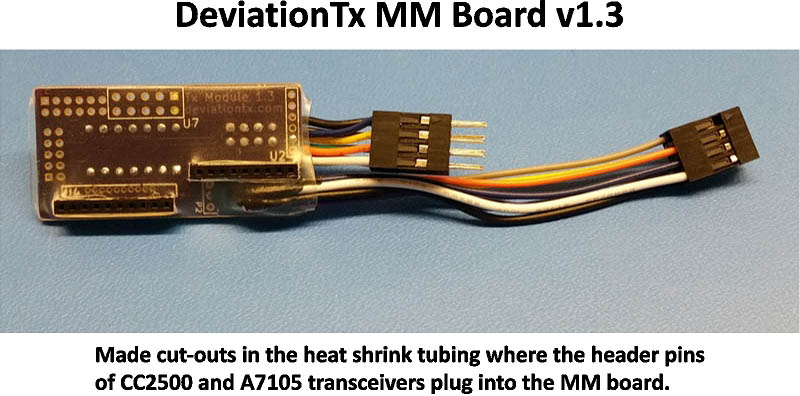

Next item, solder two 2mm female headers to the MM, piece of cake! First one turned out great, ...until I tried to plug in the male pins. :-/ Solder had sucked into a couple of sockets on it. De-soldered the damned thing and used the new solder sucker to get excess solder out of those tiny holes, worked better than solder wick. Soldered in a fresh header, being extra careful, same result! Try a third time being extra-extra careful and checking each socket as I go, working great, ...until the tenth and last socket! Arrrrgghhh! Solder sucking was tedious with these smaller holes (and more of them) Thus, back to YouTube, and learned the “tapping molten solder out of holes” against the workbench technique. Works fast and easy, just be sure to wear goggles for this because you don't want to get molten solder back-splashed in your eyes! ...and maybe wearing shorts and no shirt isn't such a good idea either.
Started thinking about how to remedy my problem:

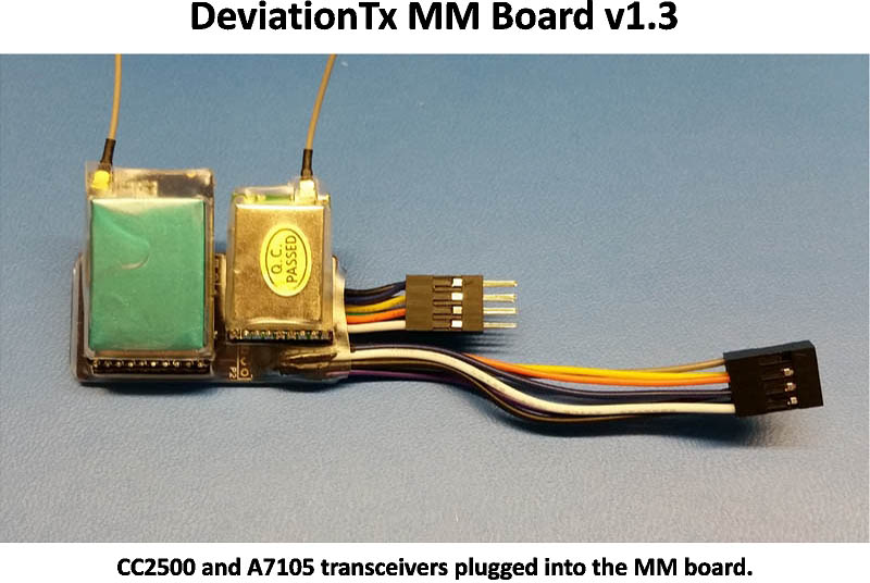

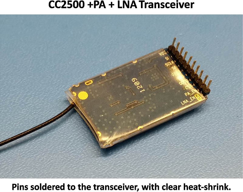

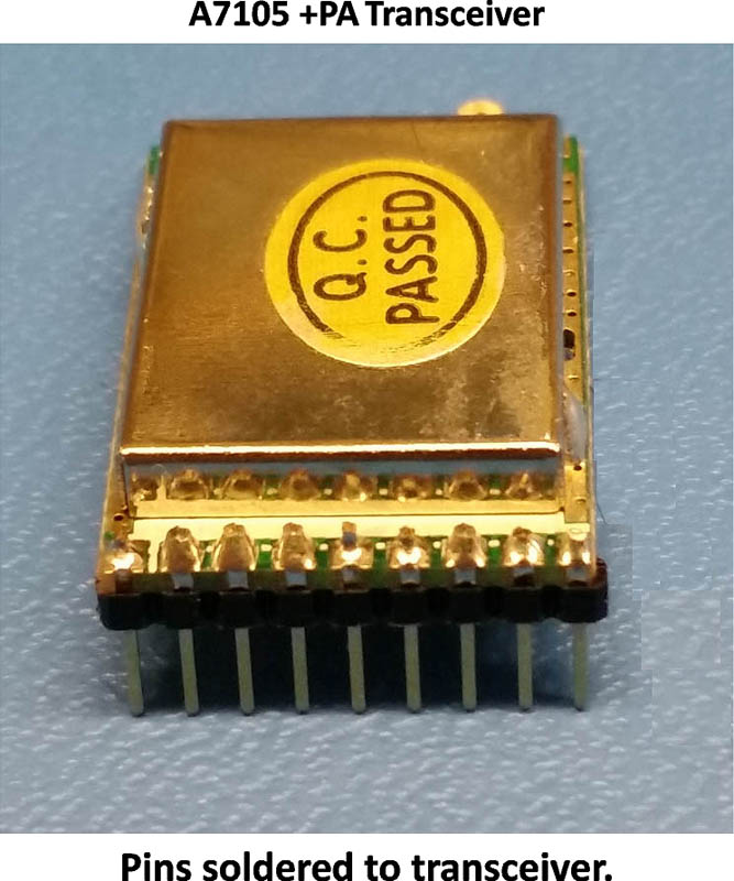

Then I soldered the corresponding pins to the CC2500 and XL7105/A7105 modules, piece of cake. As you can see from the following pics, I am not a soldering expert. …...yet, but they turned out good enough for the girls that I date. =O)

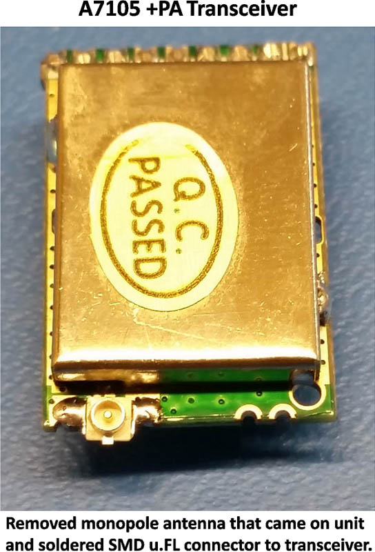

I removed the crummy antenna that came on the XL7105/A7105 and soldered on a SMD u.FL antenna connection because, well, just because I liked the idea of it instead of hacking up a coax antenna lead and making a fork out of the ground/shield wire & center conductor to solder to the 3 antenna points on the module.
Man, that u.FL thing is tiny!

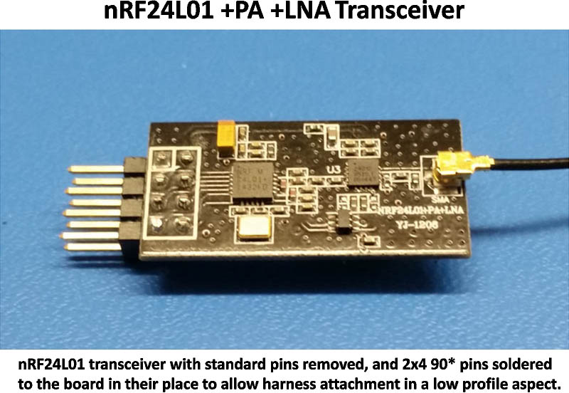

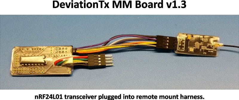

I decided to mount the nRF24L01 module remotely to keep the MM assembly a little smaller, since adding the headers made it substantially thicker than direct soldering the RF modules directly to it. So, soldered lead wires for it to the MM board, and removed the existing pins on the nRF24L01 and soldered on a 2.54mm 2x4x90* pin doohicky to it (yeah, that's a technical term) to make the connection a straight line instead of being at a right angle to the transceiver board.

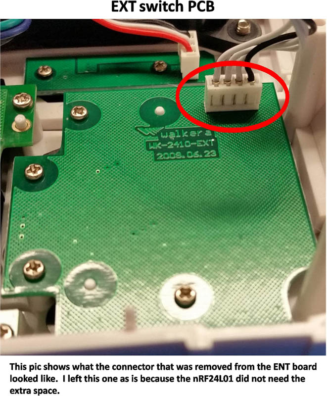

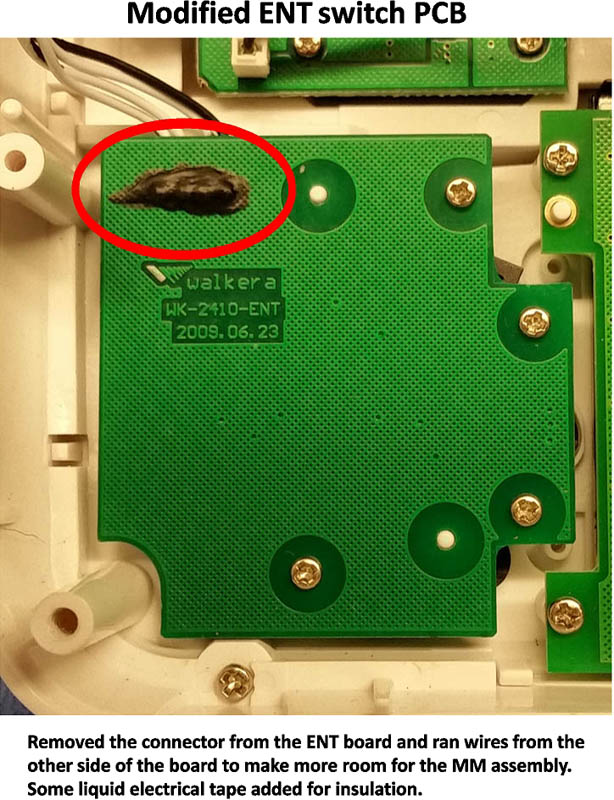

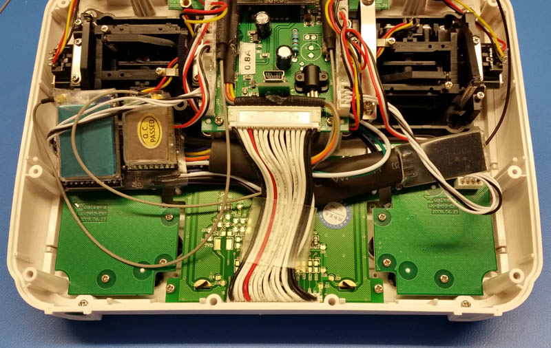

Also, to gain a little extra space for the MM, I re-did the wires going to the ENT switch by removing its header block and re-routing the wires from the other side of the ENT board. Maybe not necessary, but I did it anyway.
Now, we move on to the other part of the wire harness that connects to the main board of the Tx.

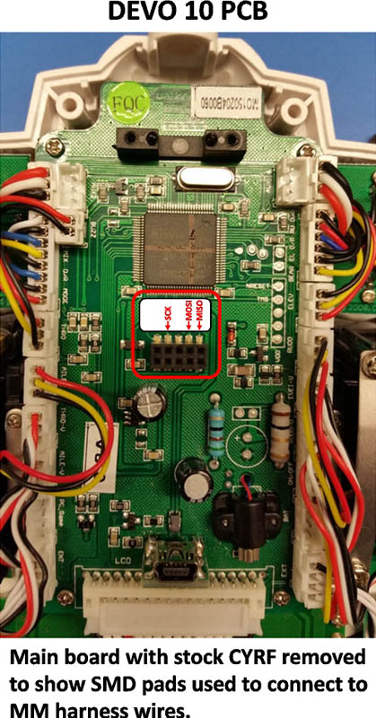

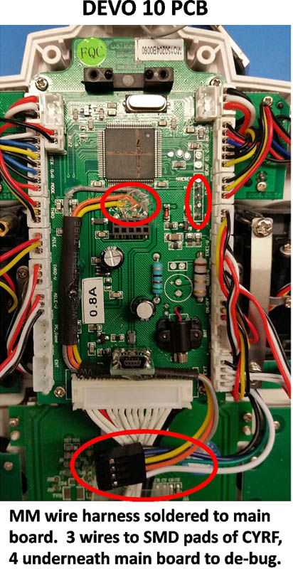

I elected to connect the SCK, MOSI, and MISO leads directly to the main board via the SMD pads on the header block of the stock CYRF module, instead of on top of the pins of the CYRF module itself.

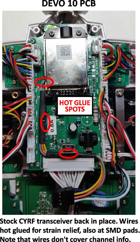

The following picture shows the harness soldered in place to the main board. The SCK, MOSI and MISO leads on top of the board, using heat-shrink tube to keep them neat and tidy, going to the CYRF SMD pads and hot glued in place. Note that I did not run them right up against the row of Tx connections so I could still read the designations for channel and switch plugs to the left side of the wires. The lower red circle is the 2x4 plug end that connects to the MM board.

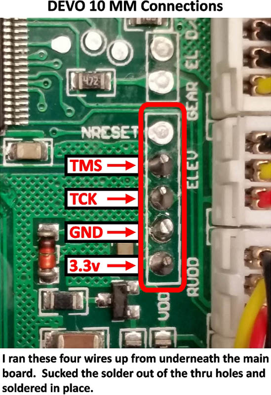

The TMS, TCK, GND, and 3.3v leads are routed under the main board and up into the de-bug port connection spots. I removed the main board to make this task easier to accomplish, but did not take any pics when it was out, as I was in the thick of it and didn't want to forget where everything was supposed to plug back in.
….and here is everything in its place, hooked up, and the Tx is all ready to be closed up!

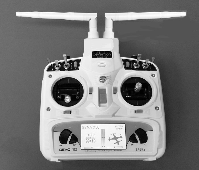

I do have a plan to change the three internal antennae to external ones, but have a bit more cogitating to do on the plan, so it will most likely change a bit from what I currently am thinking it should look like and will be a while before I start on that. At the moment, I have the nRF24L01 transceiver hooked up to the external antenna, because that transceiver controls all of the quads that I have in my little fleet.

Thanks for the compliment. I think one thing that I forgot was a picture and description of the ATtiny24A-P microcontroller being soldered to the MM board, and the proper orientation of the component to the board, but then again, that has been covered elsewhere in many how-to tutorials.
As for multiple antennae in one tube, I don't think that there is really enough room in a standard antenna tube to fit four di-pole antennae inside, You would have to use a bigger diameter tube with enough clearance for four wires at the hinge point. Also, I would think that there would be some interference of wave propagation happening to which ever antenna happens to be physically behind other antennae wires. I guess one could custom make a flat antenna tube where they all were set side by side, with none in the shadow of another one in the direction of the model being flown.
Right now, the plan is to have two standard antennae (for the most frequently used RF transceivers) out of the top where the original one is, each pointing in opposite directions when bent to 90*. For the other two, at the moment, my thinking is to have RP-SMA ends come out from the back case with two short, unobtrusive mono-pole antennae to prevent feedback damage to the transceivers in case of accidentally activating them. Then when I do want to fly with one of those transceivers, I would remove the mono-pole antenna and attach a 90* 2.4gHz cloverleaf antenna. Either that, or attach a long di-pole antenna and rubber-band it on the top of one of the standard antenna tubes that is bent at a 90* angle. That way the Tx will not look too much like a porcupine with only two typical antennae sticking out the top and two relatively unnoticeable mono-pole antennae stuck to the back of the Tx.
I'm still not done thinking about how to do it though. When I have time, I will Photoshop a mock-up to look at and see if that is what I really want to do, or not do. ...and so others can easier visualize what I mean.
Edit: A PS'ed mock-up of the front.....
Who knows, by the time I get it in gear, maybe the Single-Board Universal Module will be available and all this porcupine antenna dilema will become a moot point. Plug & Play, multiple transceiver, single antenna Tx, baby! w00t!!!

12 Jul 2015 18:42 #35378 by aMax
Simply put a coaxial termination dummy load on each of the sockets at the back and if needed , swap it with one of the existing antennas.
12 Jul 2015 19:39 #35380 by RedSleds
aMax wrote: Simply put a coaxial termination dummy load on each of the sockets at the back and if needed , swap it with one of the existing antennas.
Hmmm......., now there is a good plan!
Could even use 3 of the dummies, and only need to have 1 antenna out the top of the Tx.
