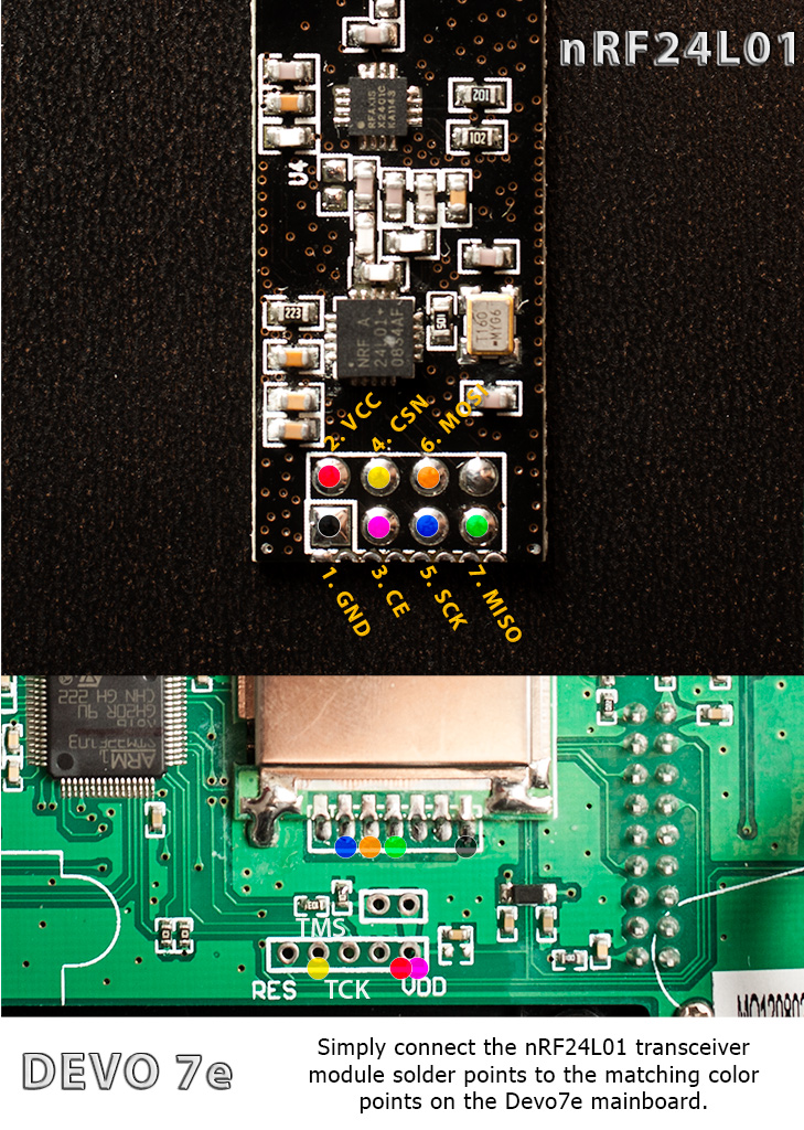

Has someone tried getting the transceiver of Stock TX of WLtoys v977? I want to get it mod my DEVO 7E so that i can bind my heli with it..
My problem is that, nRF24L01 is really different from the stock module of WL toys TX, and I don't know where to place and solder those slots.
This is what i saw from the forum on how to solder nRF24L01 to Devo 7E
please i need help !
i have spare WL toys TY thats why I want to try using the module of this one. THANK YOU!

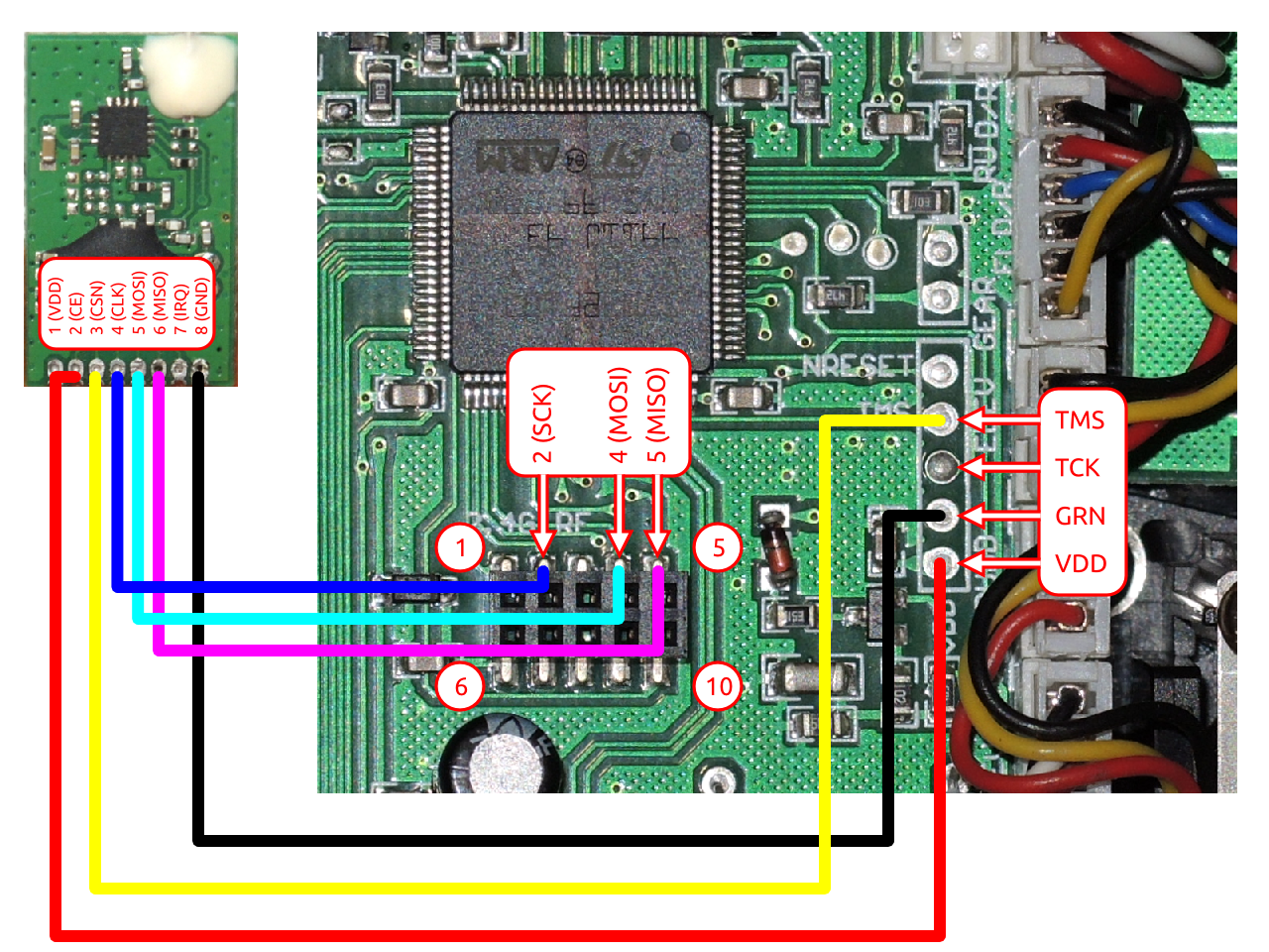

Hi. I used a module from stock V977 transmitter on DEVO10. Here is my connection diagram:
On my blog has a few more pictures, but I`m sorry, text only Russian.

sir can i use this on my devo 7E? should I just follow the numbering on the module from the picture you sent me then solder it to my devo 7E?

Just a small message from a brand new french user who just upgrade his new (but used) devo10 with a tuner coming from the stock transmitter of the v977. I used the diagram of Babay (thx
) and everything work flawlessly my v977 is much more maneuverable with the devo 10 (already 10 test flight).
