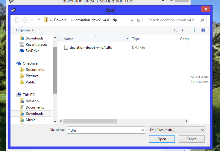

trying to follow the most current utube video and when a hook it up and try to download the .dfu it gives me a red message saying not the correct format. I tried the newest 4.0 and even 3.0 just to see if maybe it would work and nothing. I bought this devo 8s as a stand alone and not part of a package so maybe it is old maybe new so not sure if I need to do something to it first before any of this works? Ive tried to goggle the message and nothing comes up to help with it so figured time to ask some one. sucks that walkera is pulling all this off the site and not supporting such a great product.

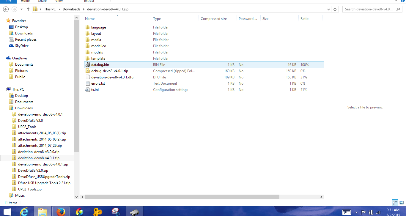

so downloaded the file and right click the zip file and hit extract all files and that is how I got to the dfu file so what am I missing on it? Sorry hadnt had to mess with this stuff in a long time so probably something stupid on my part but in the second screen shot where it gives me the option to choose the dfu file isnt it already unzipped from the main file when in that screen? hope I am making sense here sorry if confusing in explanation of it. thanks
02 May 2015 14:09 - 02 May 2015 14:12 #31951
Replied by PhracturedBlue on topic trying to upgrade a new devo 8s I just got
that is fine, but you appear to have selected the zip file itself and not the directory you extracted it to.
when you press the '...' in Upgrade File, and select a dfu file, it should show you the filename instead of "*.dfu"
the little icon you see here indicates you are looking at the contents of a zip file and not an extracted directory
