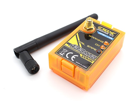

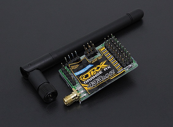

It would be very interesting to weld this module to our devo 7e and create the protocol to work.
It's great for FPV long distancie
I hope that with everyone's help we can make a tutorial.
Transmiter
Receiver
Url articules :
www.hobbyking.com/hobbyking/store/__4003...strSearch=Open%20lrs
www.hobbyking.com/hobbyking/store/__2709...trSearch=Orange%20lr
www.hobbyking.com/hobbyking/store/__2709...strSearch=Open%20lrs
Transmiter
Receiver
Url articules :

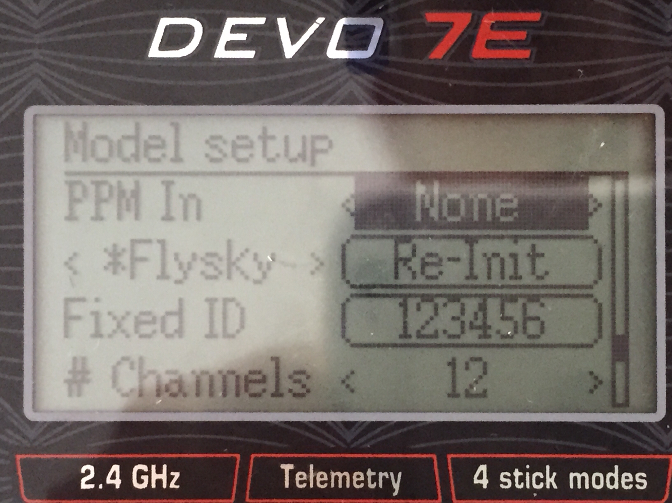

How to put this working ?
04 May 2015 18:15 #32073
Replied by Deal57 on topic Devo 7e Orange open LRS long distance 8km
Where your screen now says <*Flysky*> use the right button R+ to scroll to the PPM protocol. Section 8 of the users Manual has a detailed description.

Ok PPM
PP In : None , Channel or Stick ?
04 May 2015 19:55 #32079
None, I believe. Page 23 describes how it is up used and it doesn't seem to apply here.

ppm in won't and can't be used because you're using ppm out ppm in is for buddy boxing or a head tracker.
