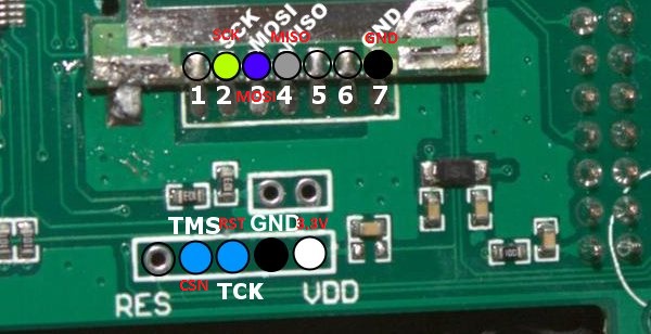

I can't get the multi module to work. Flashing was done with STK500v2 no module installed on multimod 1.3 board. I use a ATtiny24A, installed A7105 and over it the NRF24L01. I get no errors on power up, but olso the NRF24L01 doesn't work wit Assan as it did before, heave no means of testing A7105.
Also heave the small problem of closing up the transmitter(devo 7e), don't know how this should work with three modules on the multimod 13. board...
Has anyone some pictures on how to fit this in, my multimodule 1.3 board connection pinout.

It sure looks like everything is set up right. This may be a power problem as reported by a few users, and you can tell by taking off the A7105 (if possible to do) or at least disconnecting the power to it. But this is speculation.
If you can try the MM with another model, you may find that it is protocol dependent.
And there is another alternative... remove the MM and wire the modules directly. It will cut (a little) the power requirements. And it can fit into the shell more easily. If you need to have three tx modules it is still possible with a bit of very small solder.

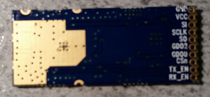

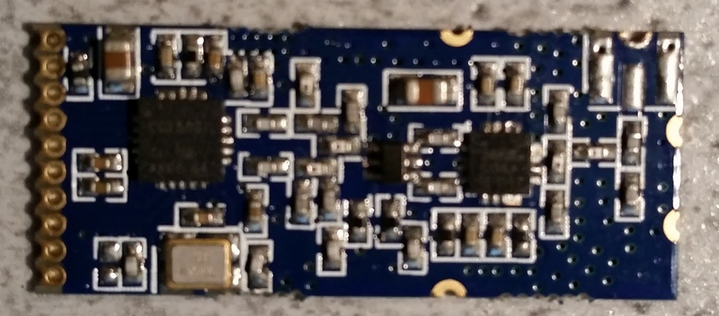

Does anyone know if this cc2500 can bi use it is not the skyartec? The pin out is different, banggood shipped me the wrong one...
Devo F7 XMS + 4in1 module
06 Oct 2016 18:08 #54669
Replied by Deal57 on topic [Solved] MultiModule 1.3 not detected by Devo7E
It's hard to tell without being able to read the markings on the chip. Can you make out any numbers on the 20pin square chip near the connectors (to the left in your photo)? If it is a CC2500 then it should be ok, and I'm pretty sure that it has the Power amp.
You would need to be sure you wire it right, because the connector has a couple of positions different than the most common one we use.

It is a CC2500 and that is a power amp, the pin's are not just mixed some are different labels.

I use that cc2500 module with great success, although I do not use multimod. For me it is much easier to solder one wire to the CPU and have all csn pin directly controlled by the main cpu.
- Bisky
- Posts: 89
08 Oct 2016 16:22 #54724
by Bisky
How did you hock up the module? The one I heave is not skyartec.
Replied by Bisky on topic [Solved] MultiModule 1.3 not detected by Devo7E
Fernandez wrote: I use that cc2500 module with great success, although I do not use multimod. For me it is much easier to solder one wire to the CPU and have all csn pin directly controlled by the main cpu.

It is indeed different than skyartec, but all pins are marked correct.
You need to connect the csn pin to A13 A14 A15 etc whatever you like into your Tx only one module connected.
Then the Tx (amplifier) en and Rx (LNA) pins en they are looped back to pins at the module to Gdo2 Gdo0, not sure anymore which.
All other lines just connect as usual.
I am certain I posted some images at the time of the wiring, there has been discussion on this one, but I can't find anymore the topic. I find using search on this site it comes back with soo many irrelevant posts that is hard to find what you looking for.
